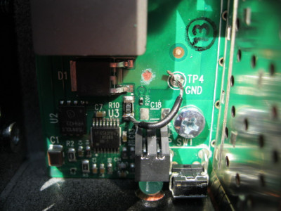

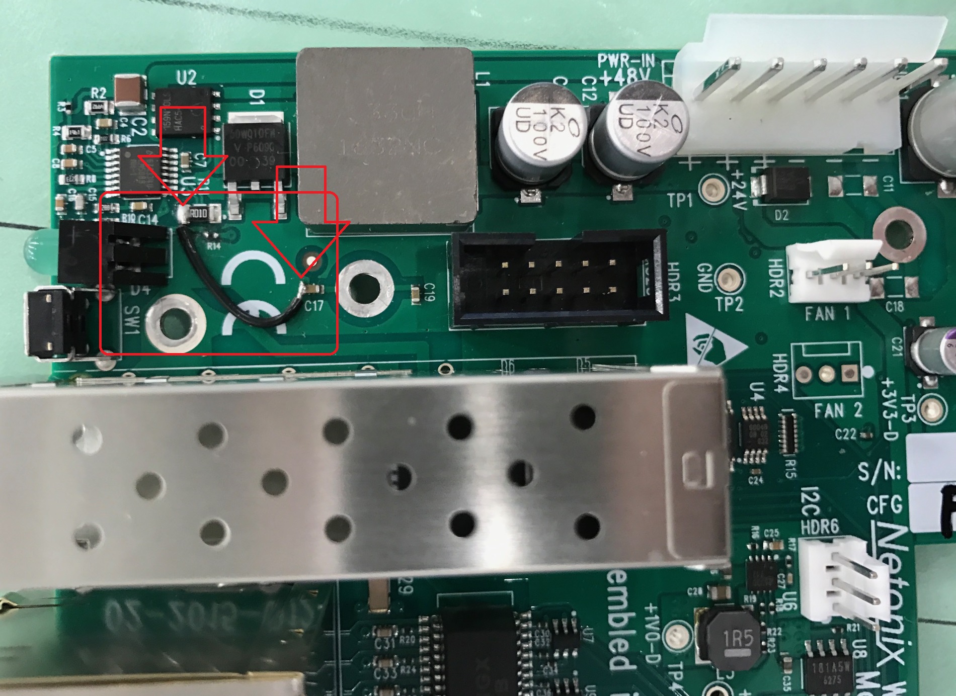

In the picture below you can see all you need to do is "carefully" solder a small wire between two parts.
Another way to tell is if you look at the board's "white stenciling", not the white rectangular box Labeled "CFG" which refers to the firmware configuration to be used, if the white Stenciling says Board Rev G it may already have the MOD done as we had the SMT shop start doing the modification mid production run. If it says Rev H or Rev I then your good. If it is Rev G or below you need the MOD if it is not already on the board as pictured above. The important thing is to take a 24AWG wire from the one side of the R100 resistor "as shown in the picture below" to any DC negative source which many of the old board Revs have a GND Testpoint right there near the R100 resistor.

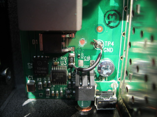

If anybody cares, could you confirm that I did this mod correctly on this WS-12-250-AC-REV_B ?? The board layout is slightly different, but TP4 GND should be OK according to the instructions.
I was able to accomplish this by removing only the lid and the serial cable harness. I left the board mounted in the base of the box. It was tight and took some hacking experience creativity. It would require less skill if the board was removed from the base. But I have about 16 of these to do, so I wanted to save all that "screwing around".
Re: Increase the on board 24V power supply capacity
Yes this is correct.
