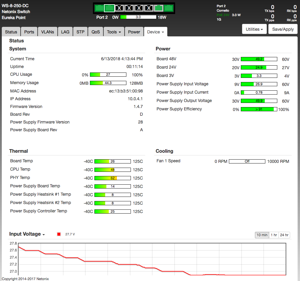

Here is a screenshot of the status page taken while the switch was still operational. I will hike back to the tower later today to reset the switch and can post additional screenshots once that's done.

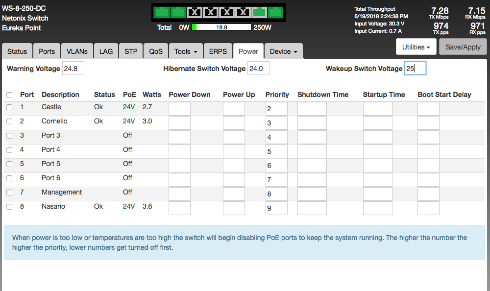

I've attached a screenshot of the power page. Based on some other forum posts it looks like I maybe should bump the wakeup voltage to 27v and the warning voltage to 26.

Re: WS-8-250-DC get's stuck in hibernation.
After investigating, it appears that this switch model was built with a DC power supply bootloader version that at the time could not updated the power supply firmware. So even though you've updated to the latest firmware for the switch, the power supply firmware refuses the upgrade since the upgrade process was not functional at that time.
Please keep in mind this switch was from our first batch of SMART DC switches and was MFG way back on 08/20/2015. Later releases of the WS-8-250-DC had an improved bootloader that allowed the power supply firmware to be upgraded. Sadly there are about 200 units out there with this bootloader on them. You can tell if you have one because no matter what version of firmware you put on the switch the power supply firmware will remain version 28 and not upgrade with the switch firmware.
To help with your issue you can RMA your switch to us and we will update the power supply microcontroller (bootloader) with the latest code so that it performs correctly allowing the power supply firmware to be upgraded.
