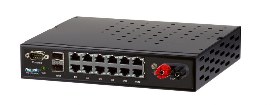

Hi Team
I recently bought a netonix switch and am currently using it to power Unifi AP Outdoor + Access points. I notice on the switch that there is a grounding terminal
on the chassis. I have not used the grounding terminal on the switch before.
There is not issues with the netonix but i would like to do grounding on the switch to prevent it from further damage.
Is there a proper way to do grounding using the grounding terminal on the switch? Please advise
The model netonix I am using is WS-12-250-DC.

Another common cause for damage is a shorted cable or incorrect POE option applied to device.
Read the posts above but the basics are as follow:
Tower ground rods must be bonded to electrical service ground rods HEAVY #2 wire.
