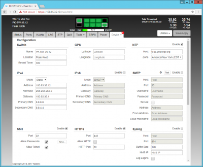

I'm assuming that the Web GUI of the WS is doing it's thing, but I can't ssh or telnet into either device to verify that they're even listening on ports 22 or 23.

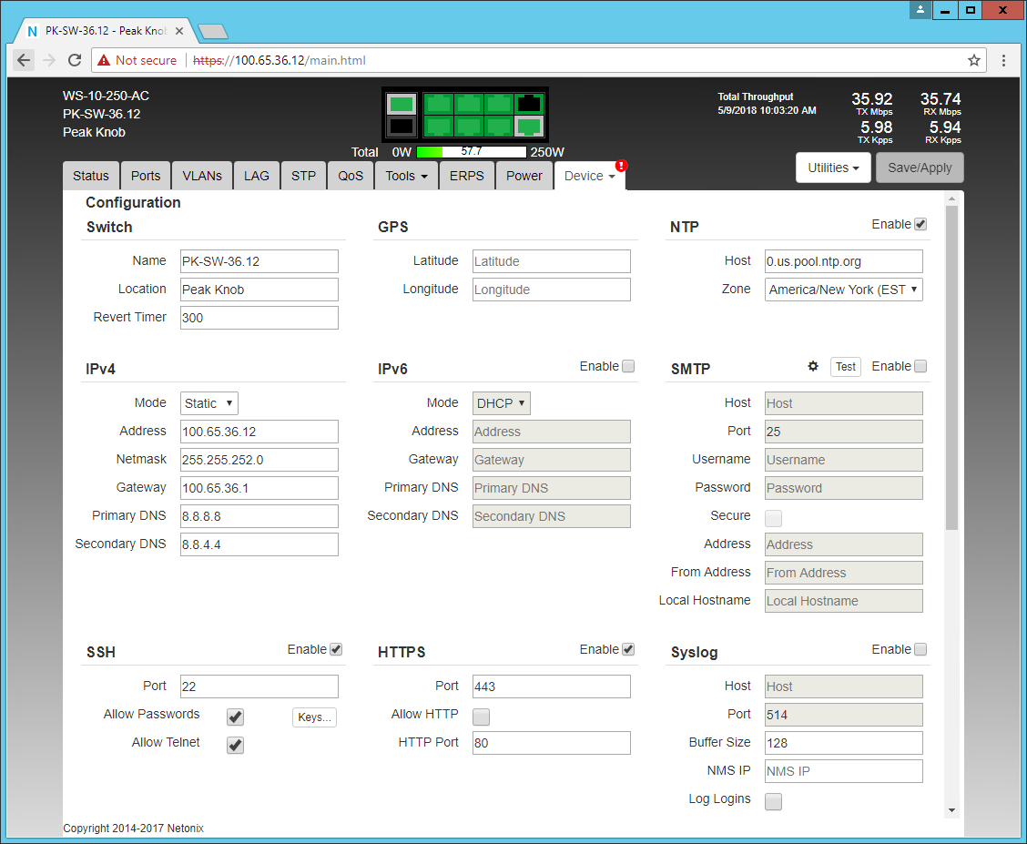

First, let's test the first switch. Connected via 1G Copper. No interface errors on either the CCR or the switch:
[troy@PK_CORE] > /sys ssh user=admin 100.65.36.12
connectHandler: Connection timed out
Welcome back!
[troy@PK_CORE] > /sys telnet 100.65.36.12
Trying 100.65.36.12...
telnet: Unable to connect to remote host: Connection timed out
Welcome back!

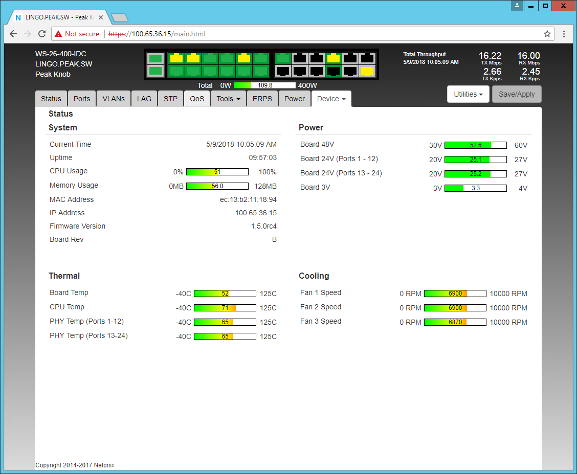

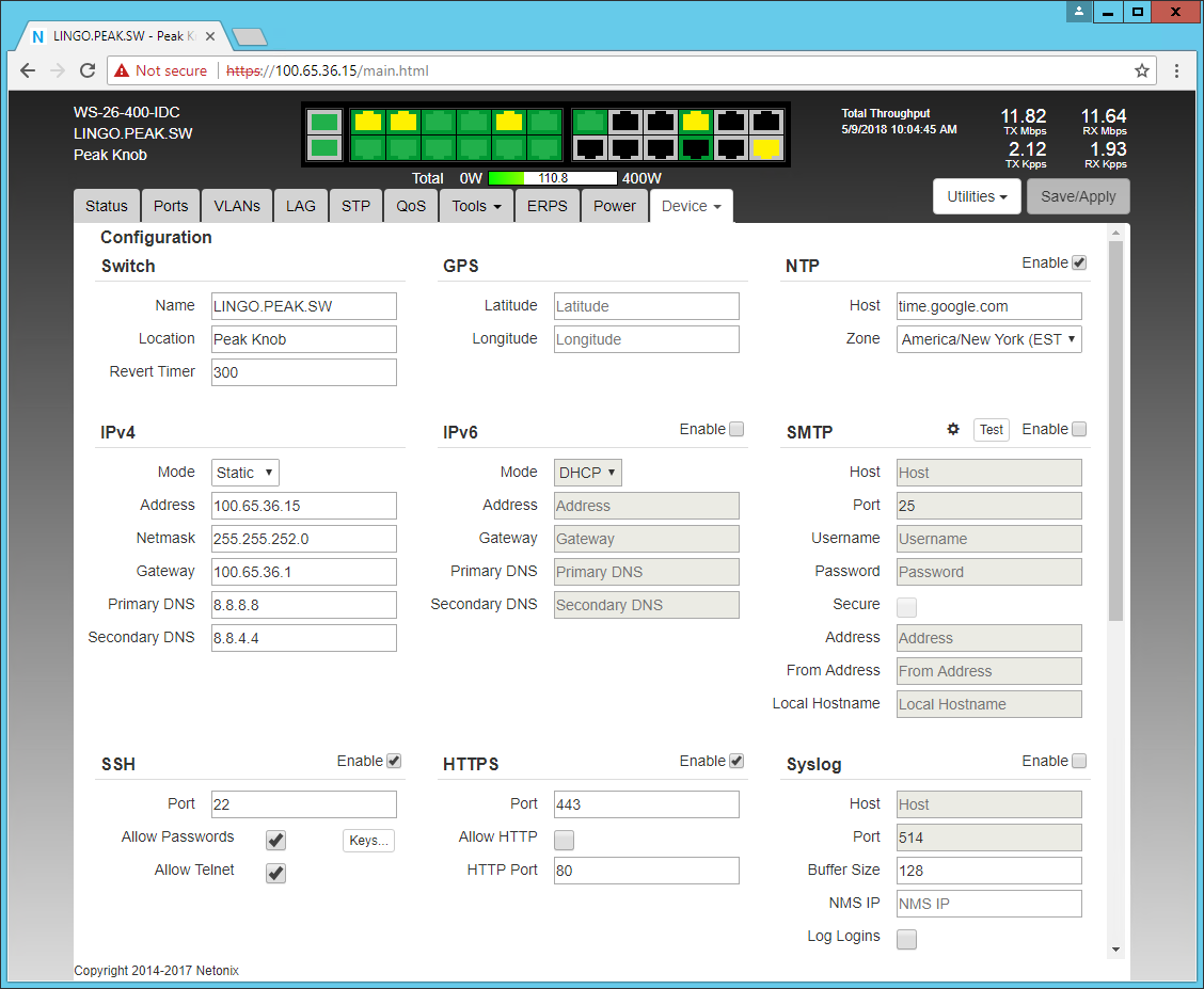

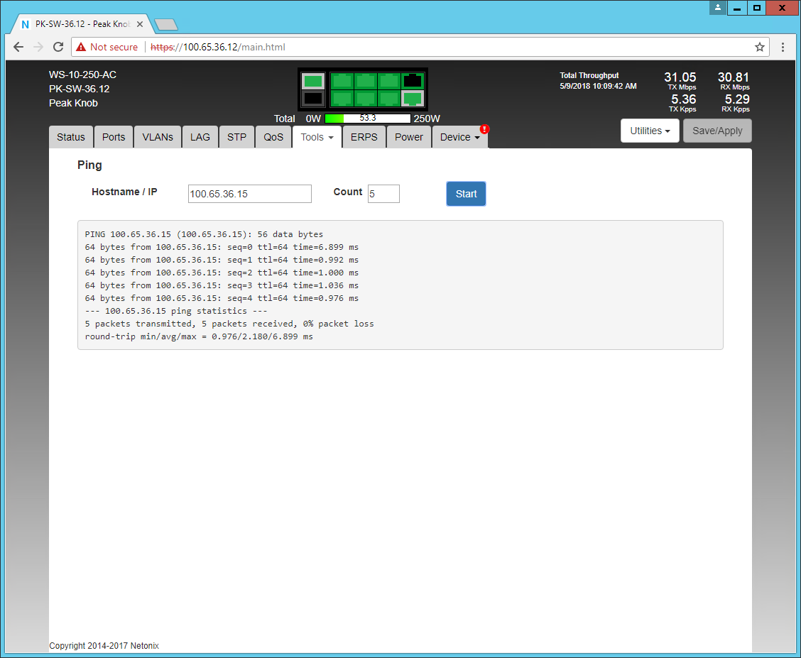

Next up, is the 2nd switch. Connection is via a single mode, bi-directional SFP on either end. Neither switch shows any interface errors here either.
You'll notice that this switch is running RC. It was on 1.4.9, I downgraded it to 1.4.8, then upgraded it to 1.5.0rc4. Behavior repeats on all 3 versions.
[troy@PK_CORE] > /sys ssh user=admin 100.65.36.15
Welcome back!
[troy@PK_CORE] > /sys telnet 100.65.36.15
Trying 100.65.36.15...
Welcome back!
[troy@PK_CORE] > ping 100.65.36.15
SEQ HOST SIZE TTL TIME STATUS
0 100.65.36.15 timeout
1 100.65.36.15 56 64 537ms
2 100.65.36.15 timeout
3 100.65.36.15 timeout
4 100.65.36.15 56 64 177ms
5 100.65.36.15 timeout
6 100.65.36.15 56 64 894ms
7 100.65.36.15 56 64 0ms
sent=8 received=4 packet-loss=50% min-rtt=0ms avg-rtt=402ms max-rtt=894ms

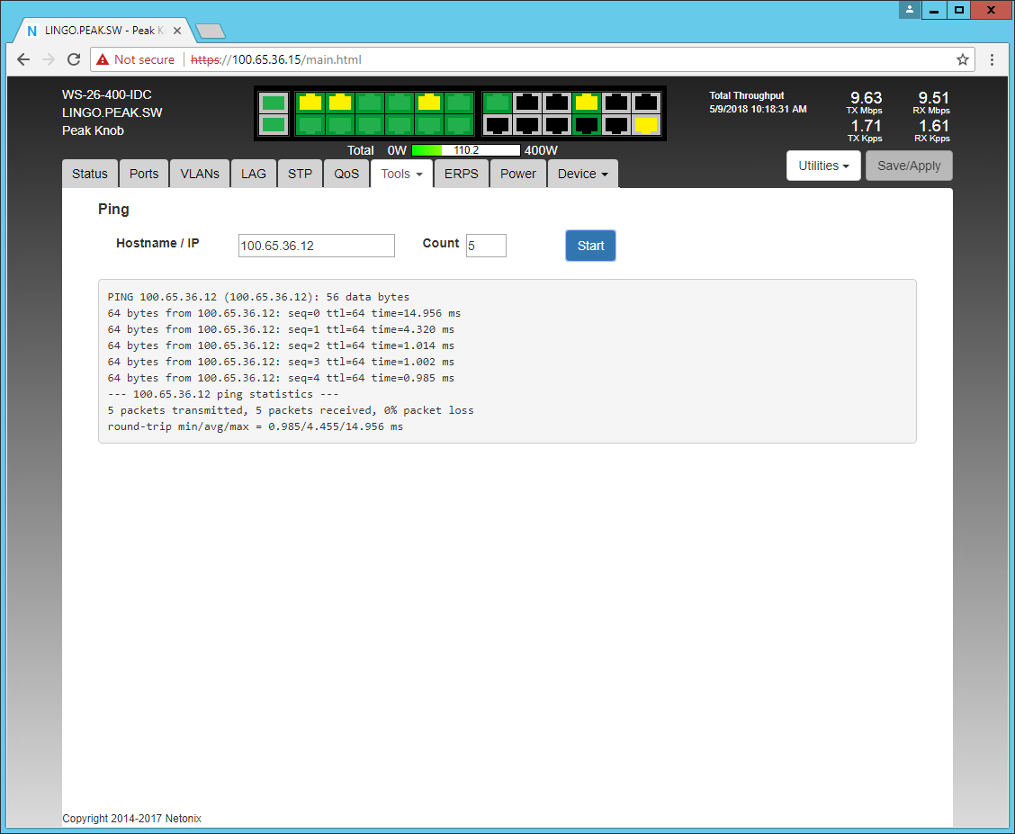

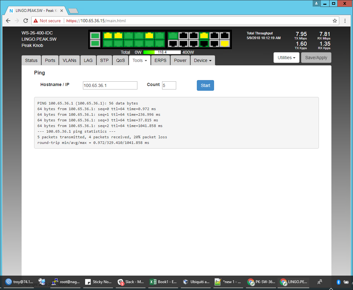

Just to follow up. I defaulted the WS-26-400-IDC and reconfigured. Same weird behavior on ICMP. It is, however, accepting ssh/telnet connections, which I suppose is progress. Still running 1.5.0rc4.
Code: Select all
 0 100.65.36.15 56 64 767ms
 1 100.65.36.15 timeout
 3 100.65.36.15 56 64 459ms
 4 100.65.36.15 timeout
 6 100.65.36.15 56 64 130ms
 7 100.65.36.15 timeout
 8 100.65.36.15 56 64 893ms
 9 100.65.36.15 56 64 0ms
 10 100.65.36.15 timeout
 11 100.65.36.15 56 64 846ms
 12 100.65.36.15 56 64 0ms
 13 100.65.36.15 timeout
 14 100.65.36.15 56 64 887ms
 15 100.65.36.15 56 64 0ms
 16 100.65.36.15 timeout
 17 100.65.36.15 56 64 746ms
 18 100.65.36.15 56 64 0ms
 19 100.65.36.15 timeout
 sent=20 received=11 packet-loss=45% min-rtt=0ms avg-rtt=429ms max-rtt=893ms
Code: Select all
Connected to 100.65.36.15.
Escape character is '^]'.
PEAK.SW.36.15 login: admin
Password:
BusyBox v1.19.4 (2017-03-07 13:42:37 EST) built-in shell (ash)
PEAK.SW.36.15#
PEAK.SW.36.15#
PEAK.SW.36.15# ping 100.65.36.1
PING 100.65.36.1 (100.65.36.1): 56 data bytes
64 bytes from 100.65.36.1: seq=0 ttl=64 time=1814.219 ms
64 bytes from 100.65.36.1: seq=1 ttl=64 time=814.821 ms
64 bytes from 100.65.36.1: seq=2 ttl=64 time=1.935 ms
64 bytes from 100.65.36.1: seq=3 ttl=64 time=1518.530 ms
64 bytes from 100.65.36.1: seq=4 ttl=64 time=519.048 ms
--- 100.65.36.1 ping statistics ---
5 packets transmitted, 5 packets received, 0% packet loss
round-trip min/avg/max = 1.935/933.710/1814.219 ms
PEAK.SW.36.15#
