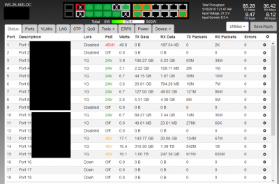

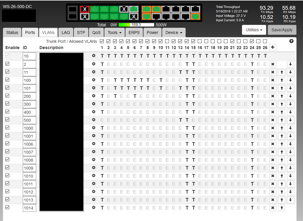

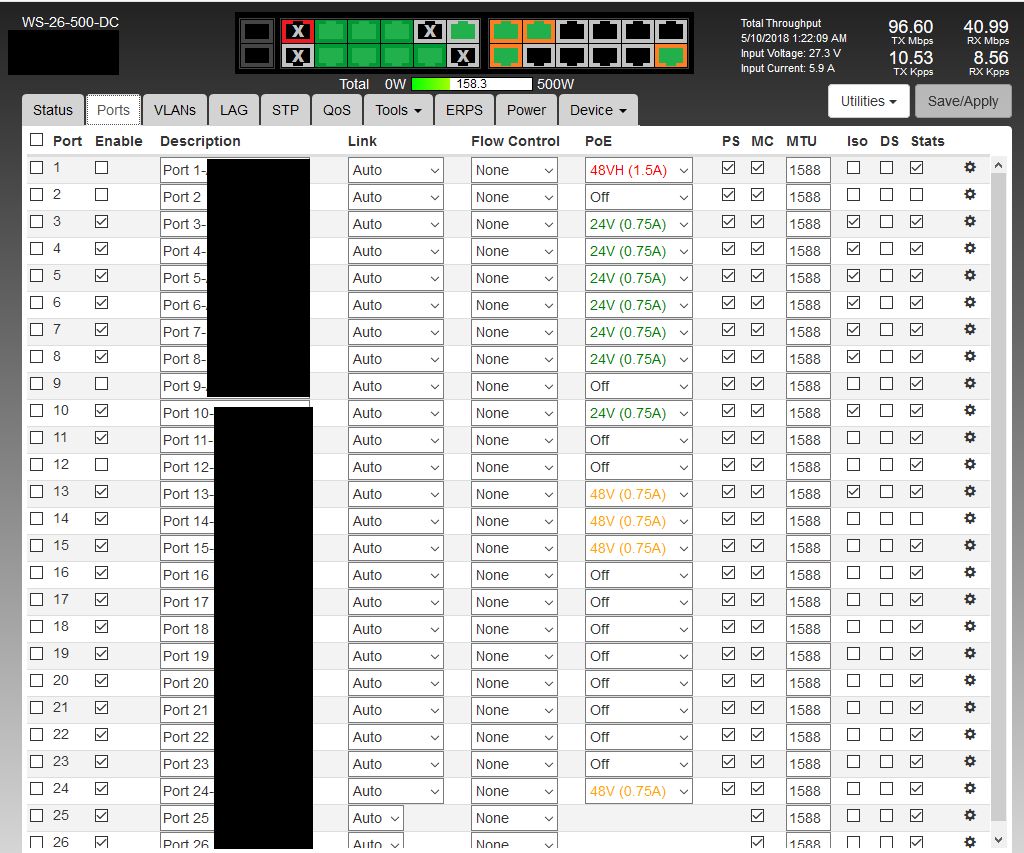

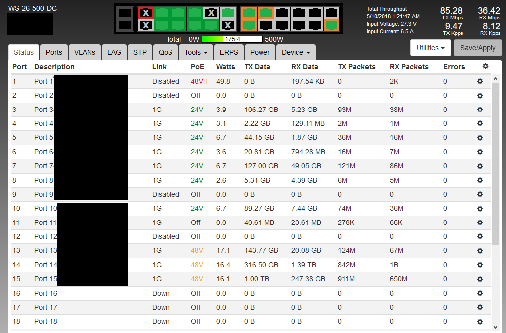

If you could, please post screenshots of all the tabs on your switch. Specifically the Status, Ports, and VLAN tabs, but the more you post the more it will help.

Attached requested tabs.
LAG/STP/QOS/ERPS are all disabled or n/a
Ports 1 and 15 are the ones that are identical behind radios that end on the same remote switch. In the photos you will see that the active port is 15 and port 1 is disabled.
If we enable port 1 and disable port 15, then save - we have to reboot in order for the switch to pass traffic appropriately.

Both ports are in trunk mode so the vlan tab is not use. In trunk mode, it's the allowed vlan list that is use. Click on trunk check bot at the top vlan to see allowed vlan for the port.

The trunk allowed list have the same vlans as the ones that are checked - this goes for all ports. So essentially the ones that have trunk port checked in their lists have the same vlans that are marked as "T".

More informations would help even if those seem simple. Could you give us Mikrotik interface config including VLAN ID with wireing schema + the Netonix trunk config ?
