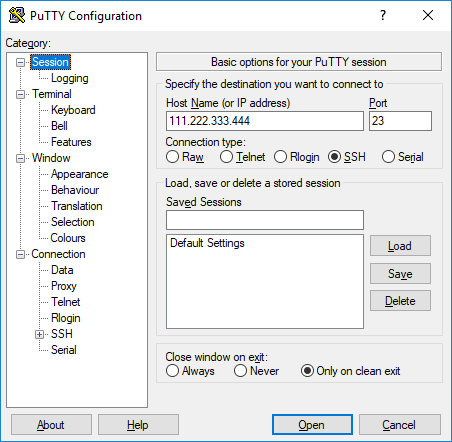

sirhc says:
"When you SSH into the device you land in the CLI, there is no way to initially land in the Linux Shell (that I know of)"
I have found it real easy to do.
If I use vanilla PuTTy with SSH I have no problems getting to the Netonix shell (I assume this is the correct terminology) - see attachments "PuTTy session start.png" and "PuTTy session log.txt".
However if I use the PuTTy plink command line capability I land in the command line shell and can find no way out - see attachment "plink session log.txt".
How can I use plink to issue Netonix commands to the switch?
BTW the switches port 22 is forwarded to port 23
I am looking at programmatically setting up scripts using plink so this is a major roadblock - any and all help greatly appreciated.
Thanks...
