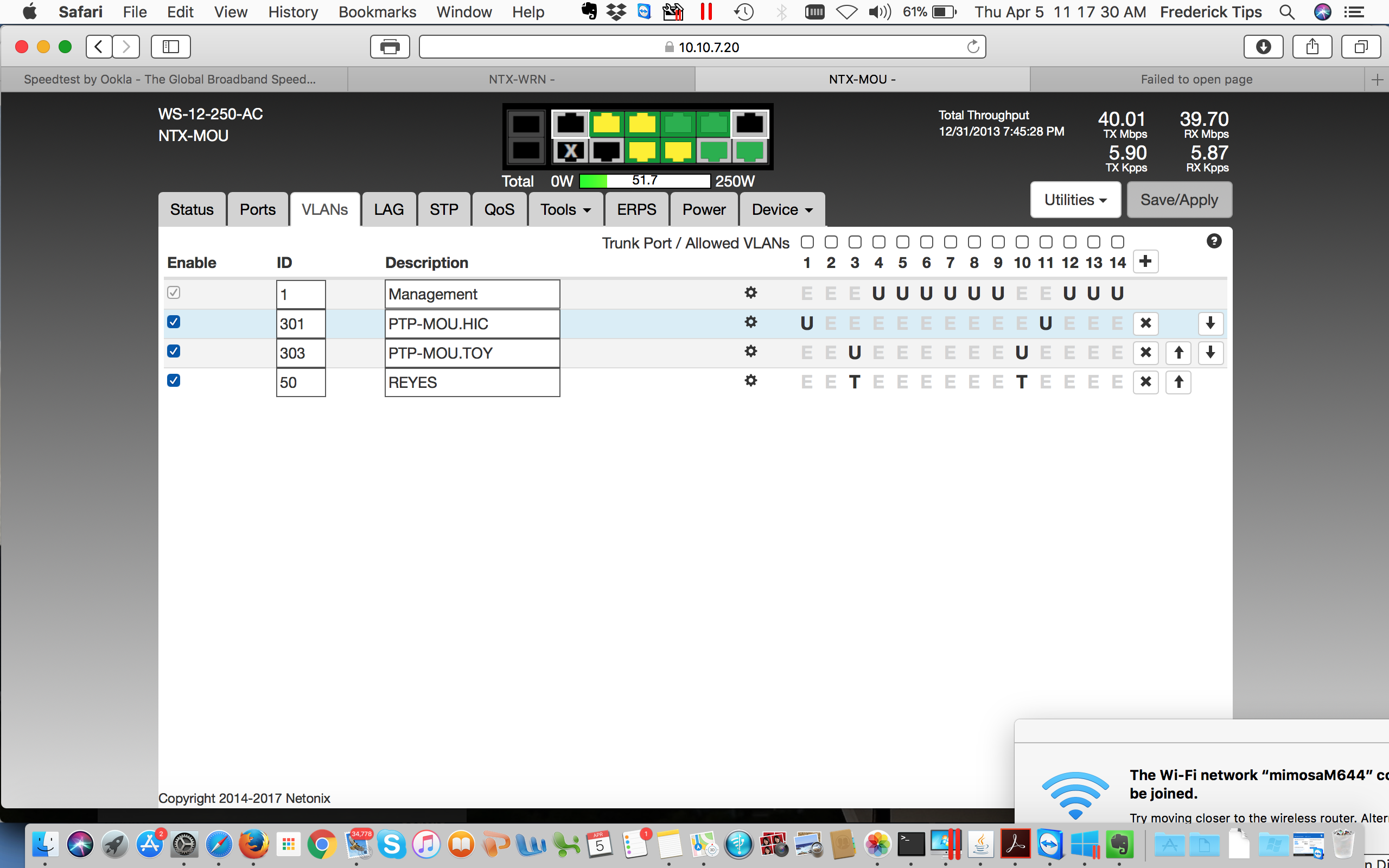

We have a Netonix 12 port 250w AC switch with 4 vlans
1 Manangement
50 REYES
301 PTP-MOU.HIC
303 PTP-MOU.TOY

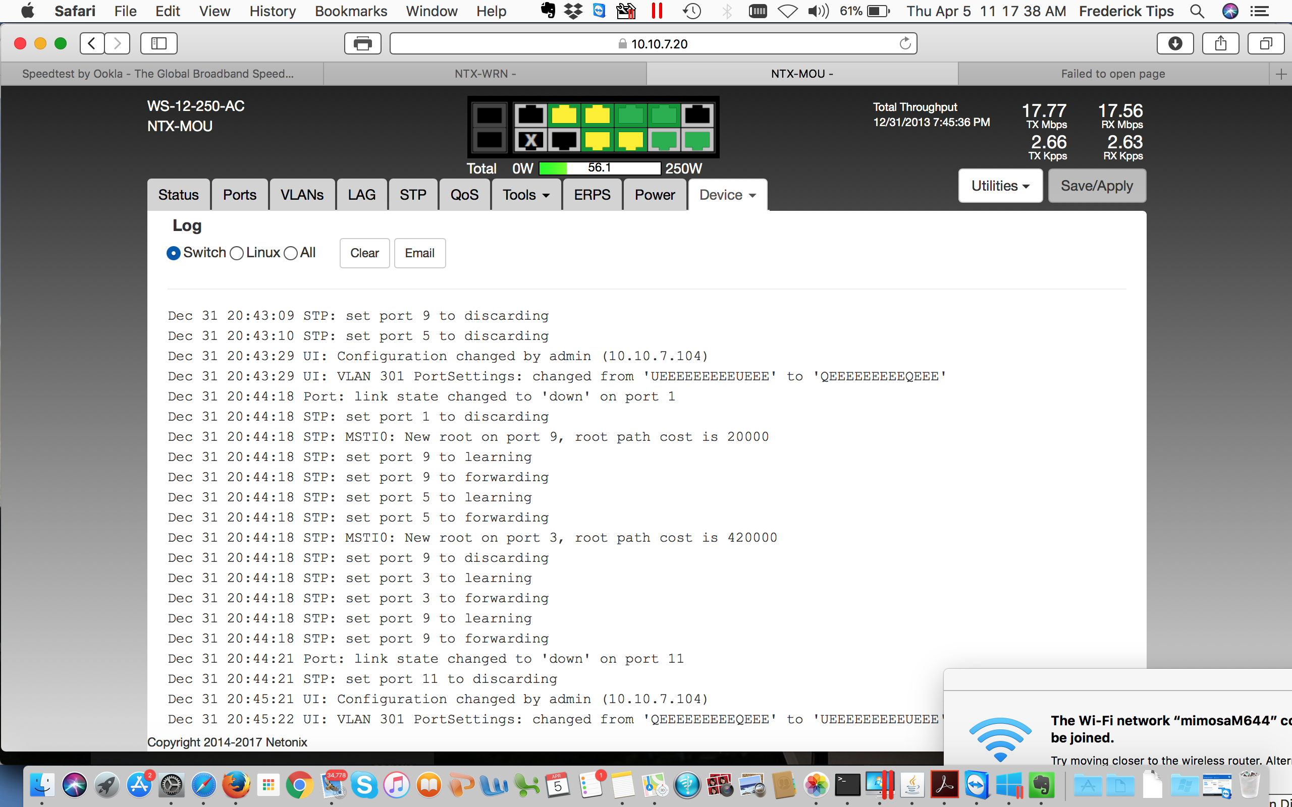

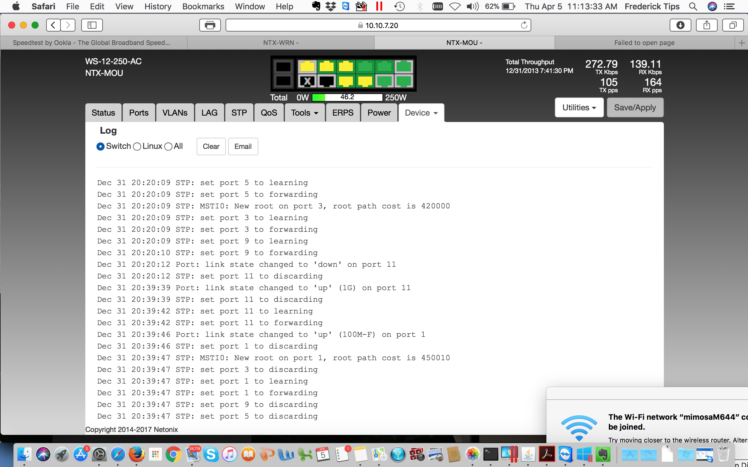

Problem is when we run traffic through VLAN 301 it causes all of the some of the ports in the Management VLAN to stop passing traffic and the ports in VLAN 301 to stop passing traffic. Log file indicates that ports 3,5 and 9 are set to discarding.
Once we disconnect the ports in this vlan, all traffic resumes as normal. We have also tried to do this on different ports and the same thing happens.

They are going to discarding because of STP/RSTP because you have a loop somewhere.
