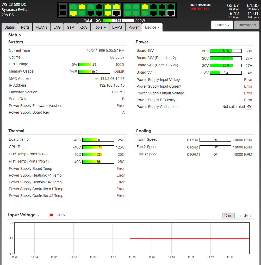

One of my WS-26-500-DC switches is showing Error on most of the power supply graphs after upgrading from 1.5.0rc1. Image attached.
Thank you
-Aaron

aaron@futuretk.com wrote:One of my WS-26-500-DC switches is showing Error on most of the power supply graphs after upgrading from 1.5.0rc1. Image attached.
Thank you
-Aaron
That is why we have v1.5.0rc3, this thread is ONLY for v1.5.0rc3 or newer which is the current firmware version we are working on.
v1.5.0rc1 is fine that you installed but install v1.5.0rc3
If you downloaded v1.5.0rc2 DELETE IT AND NEVER USE IT AS IT "COULD" BRICK THE FOLLOWING SMART DC SWITCHES
WS-8-250-DC - OLD DISCONTINUED UNIT NOT TO BE CONFUSED WITH WS-8-150-DC WHICH IT WILL NOT HURT
WS-12-250-DC
WS-26-500-DC
Julian
Thank you
-Aaron
Aaron - this can happen. Sometimes a warm reboot will fix this, but most of the time it needs a hard reset (power cycle) to clear.
Thanks!

sirhc wrote:v1.5.0rc1 is fine that you installed but install v1.5.0rc3
Chris, if you look closely at the screenshot you will see that it is in fact rc3. Might that be one of the units that should have the wire harness rerouted?
Fixing the I2C cable (if needed) is always a good idea but with rc3 it is not so much needed.
The I2C cable is not what causes this issue, it just happens once and a blue moon and we have no idea why but a power cycle fixes it.
I have rebooted switches hundreds of times trying to recreate it so we could trouble shoot it but with no luck and when customers encounter it they just want it gone so a power cycle clears it.
The odds in it happen has to be something like 1 in thousands of reboots.

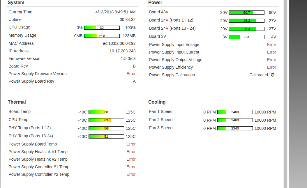

I have a WS-26-500-DC unit running rc3 that's still rebooting, though it hasn't had the wiring adjusted internally. After it was upgraded to rc3 a lot of the sensors were reporting error. It's had a warm reboot after upgrading, which never cleared the errors.

rwineteer wrote:I have a WS-26-500-DC unit running rc3 that's still rebooting, though it hasn't had the wiring adjusted internally. After it was upgraded to rc3 a lot of the sensors were reporting error. It's had a warm reboot after upgrading, which never cleared the errors.
You need to do a power cycle. Since your there doing the power cycle you could also check the I2C cable.
