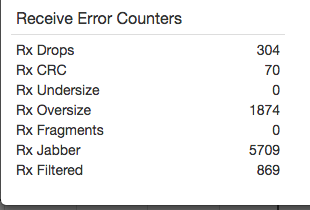

I'm not sure what to make of this. As far as I can tell there are no physical issues on the Ethernet medium. And I've never seen this before.

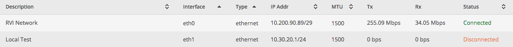

This is a PtP link:
EdgeRouter--->Netonix--->11x~~~11x--->Netonix--->EdgeRouter
There is a /29 between the edgerouters. MTU on the switch is 1528, on the edgerouter is 1500. Why am I seeing oversized and jabber errors, to begin with -- with such huge quantity?
These errors are counting up hundreds per minute.

Changing the MTU on the switch from 1528 to 2000 caused JABBER and FILTERED RX errors to stop counting. CRC errors are still counting up slowly.
Why would a larger MTU, when the router, which is sending packets to the radio is set to 1500, stop the JABBER and FILTERED RX errors?

The edgerouter probably reports the IP MTU, while the Netonix switch uses the mtu of the entire ethernet frame, so you have to add the size of the ethernet header/encapsulation. If you add vlan-tagging/QinQ, you will have to increase the mtu on the switch.

There's literally no VLAN going on on this connection though.

mhoppes wrote:When plugged into another brand of switch these errors do not happen. This leads me to believe there is a problem with the Netonix switch and the way it is interacting with the airFiber11 radio.
Here's 2 examples... no real problem with errors but I must say the stats on all other equipment connected to these switches are a lot cleaner.
AF11X and WS-12-250-DC - 122 days uptime:
Rx Drops 50460
Rx CRC 2
Rx Undersize 0
Rx Oversize 22
Rx Fragments 1
Rx Jabber 66
Rx Filtered 12988608
AF11X and WS-12-250-DC - 36 days uptime:
Rx Drops 2736
Rx CRC 7
Rx Undersize 0
Rx Oversize 634
Rx Fragments 0
Rx Jabber 1993
Rx Filtered 1669
