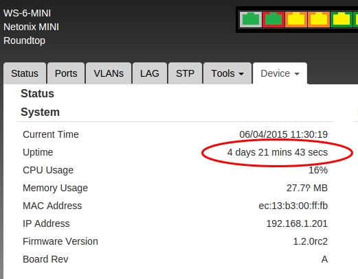

Do we have a general thread going for minor UI cosmetic stuff? I'd like to suggest that the Uptime under Device > Status get a little TLC. When I first bring it up, I get x days xx hours xx mins xx secs. Well, actually, the xx part not so much as it doesn't pad out to two spaces so the line length jumps about (pet peeve), but that is not the real bug. The real bug is that at some point it stops reporting the hours, and just show x days xx mins xx secs.

The line length jumps around even more when the days part disappears. On my MINI it doesn't seem to come and go, but on 1.1.8, it disappears for a second and then returns. I think I was unclear on that.

lligetfa wrote:...
But hey! Look at it as a good sign, when all we can find are minor cosmetic bugs to bitch about. Sweeping
Do you know if "hours" disappears when it actually has a value of zero?
btw having "zeroes", even leading, on a date would not be a bad thing :smile:
