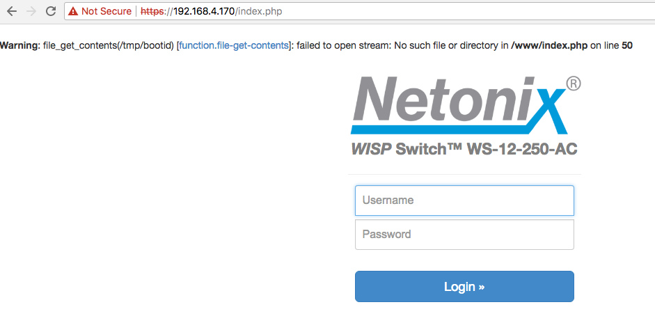

So on logging in, I see the following in the web UI:
On ssh-ing in, I have this:

Re: UI errors, console errors
Tue Mar 13, 2018 2:16 pm
if you land at a normal shell, run through the tftp firmware recovery process.
Corrupted config, looks like.

Actually, I have a better idea of what's going on here. This is a new unit, so default user/pass. And while the UI states that the VLAN IPs are not routable and for "watchdog only", they are in fact very routable and I see a single ssh login yesterday that's not from an IP I recognize. So I think some bot was trying to turn this into part of a Mirai botnet or something and has screwed it up. I have my config saved off via the auto-tftp feature, and I have "config.json" in /www.
