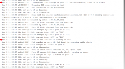

I'm running 1.4.8 on this switch, but I see no indication of a resolution of this issue in 1.4.9.

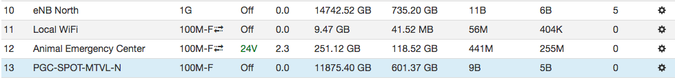

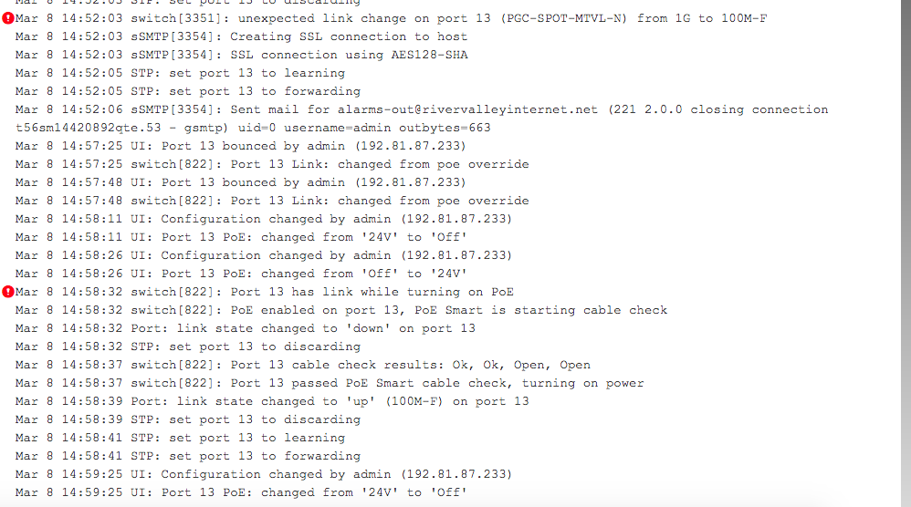

Today I had a radio that dropped from 1G to 100M-F and I couldn't communicate with. I tried to bounce the port and no go... did nothing. Log showed power was removed and re-applied... but it wasn't.
I tried manually dropping power and reapplying 24V. With the power turned off, I still had a link.
I finally just disabled the port, changed it to 1G, then saved, then enabled and set back to Auto and it came back at 1G auto and worked.
What on earth?? PGC-MTVL-SPOT is the one in question. Also, PoE smart was on... I turned it off and nothing changed.

You should still upgrade your firmware Matt.
Is the Port bounce not working still?
This makes no sense unless the switch port MOSFET is damaged and permanently stuck in the ON position?
See if port bounce is still not working and let me know.
The fact that the Ethernet communications was also stuck so to say may indicate that there possibly is damage on that port?
The link problem could have also been on the radio side whereas it was stuck and when you disabled the Ethernet port in the switch and re-enabled it forced the radio to renegotiate. Make sure the radio port setting is set to AUTO.
You need to do some testing and let me know.
On the Status TAB are the watts being correctly reported? If not this would further indicate possible damage to the port most likely ground current?
You could try a reboot and while your at it firmware upgrade and if port bounce is still not working you need to RMA the unit.
Make sure tower ground rods are always bonded to electrical service ground rods or ground current damage will occur.
