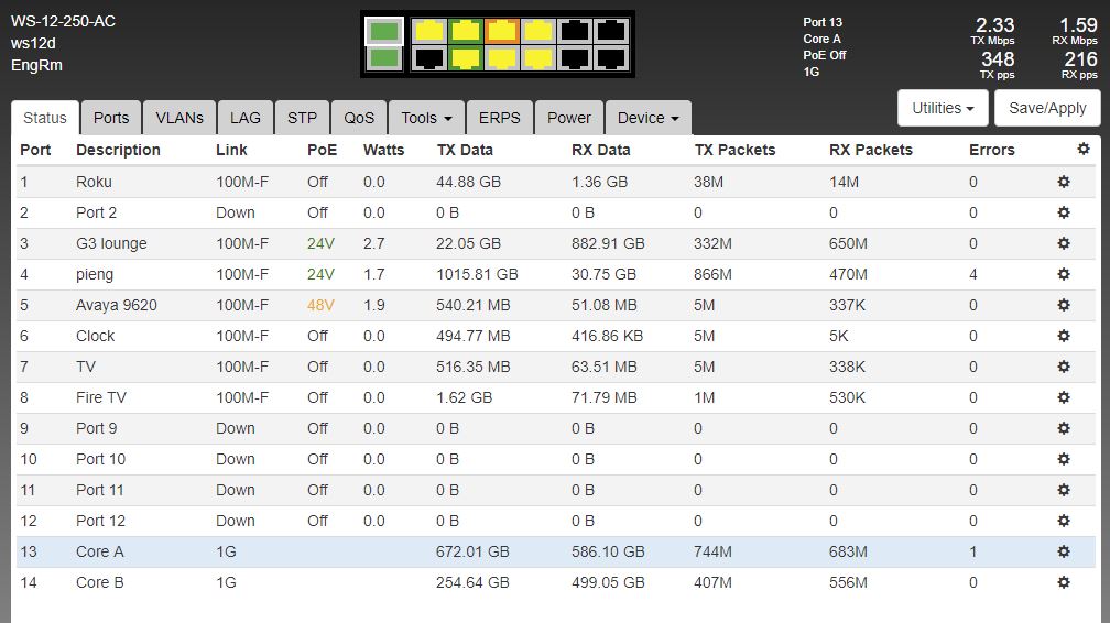

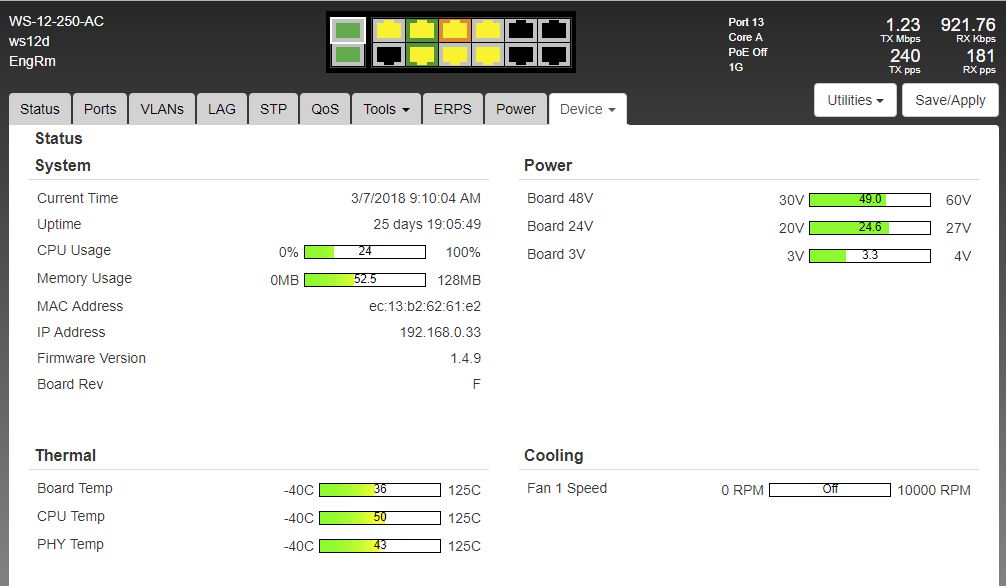

An SFP reset happened this morning and port 15 is mentioned in the log.
Not sure if that is the LAG or a port numbering error in the code.
Recall there was a numbering issue at one point, but couldn't find anything similar in other posts.
Version 1.4.9, Board rev F

Everything is working fine, just never saw that port # before.

Possibly a bad SFP module?
Since we use the same switch core for all switches (current models) SFP 0 and 1 are seen as ports 25 and 26 then Eric has to re-map the port numbers to the Log which SFP 0 becomes Port 13 and SFP 1 becomes Port 14 on a WS-12
When you create a LAG the switch now see that as a single Port which becomes Port 15

Thank you, that is what I suspected and wanted to be certain.
Yeah I think that SFP is going. Will re-seat it later to see if it helps, and swap if it happens again.
Nothing wrong on the Netonix side as usual, just confused by the # 15. Thanks.
