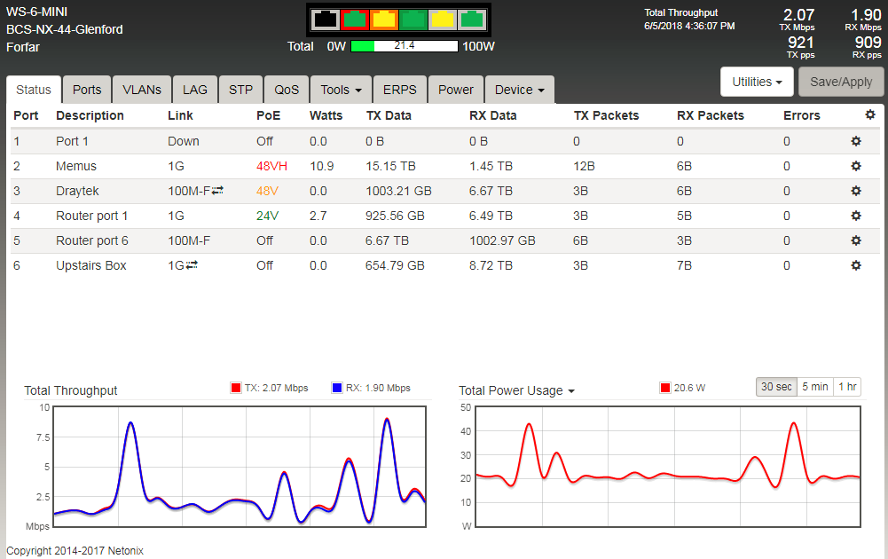

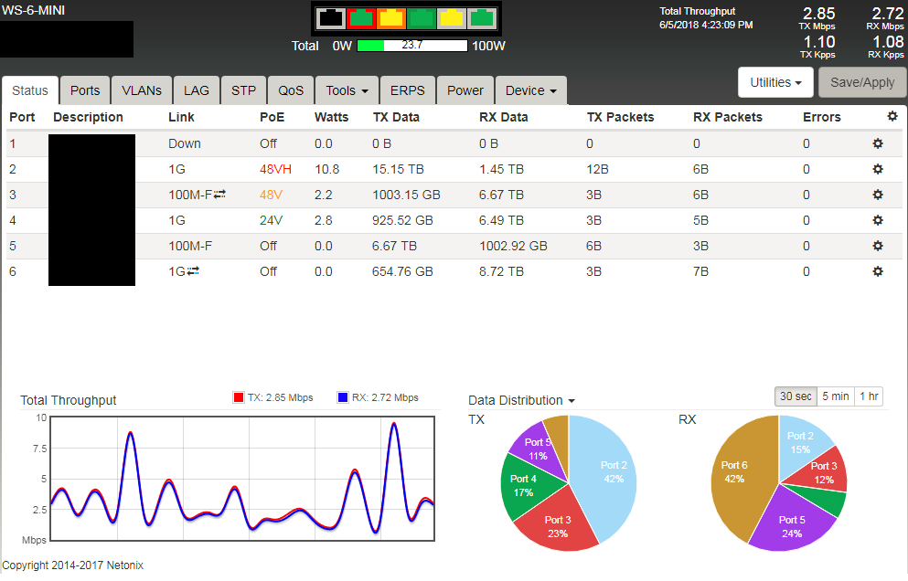

Re: 24V is out of range
Hey Chris,
I've a switch in the field that's been complaining about the same thing. Here's the log since the last time it was cleared. A few times a day, and we only lose a few seconds - no intervention needed.
Do you think this is likely to be the same problem? Or is it more likely something dodgy draining the power?
We have 5 ports in use, 3 doing PoE.
Port 2- 48VH,
Port 3- 48V,
Port 4- 24V
Port 3 seems to be drawing intermittently ~0 and 20W, which would bring total consumption up to ~45W. Total Power Usage chart confirms this, normally stable at around 20W with spikes up to just over 40W
- Code: Select all
Apr 27 11:32:49 switch[988]: 24V is out of range (22.7V)
- removed counteless duplicate entries
Jun 5 10:45:30 switch[988]: 24V is out of range (22.8V)
Port 2- 48VH,
Port 3- 48V,
Port 4- 24V
