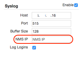

So I had syslog setup on a few switches and didn't pay much attention to it until I had a problem with one switch and found that I had no logs - not before losing connectivity nor after regaining it.
The config looked not unlike this:
Note that "Host" is filled in (the syslog host, one would presume), and the "NMS IP" is blank. This validates and saves without error.

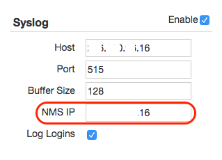

I then added the IP I had in the "host" field to the "NMS IP" field and logging started:
I'm totally lost on what the difference is between these two fields. "Host" would imply "the host I want to send syslog messages to", and "NMS IP" I'm guessing means "Network Management Station IP". Both make sense as a destination, but if NMS IP is required for remote syslog, then require the field. Host is required and appears to only accept an IP.
What's the difference? I thought maybe "Host" was to be the switch's hostname and would prepend to the logs, but it's not that as it doesn't accept a hostname...

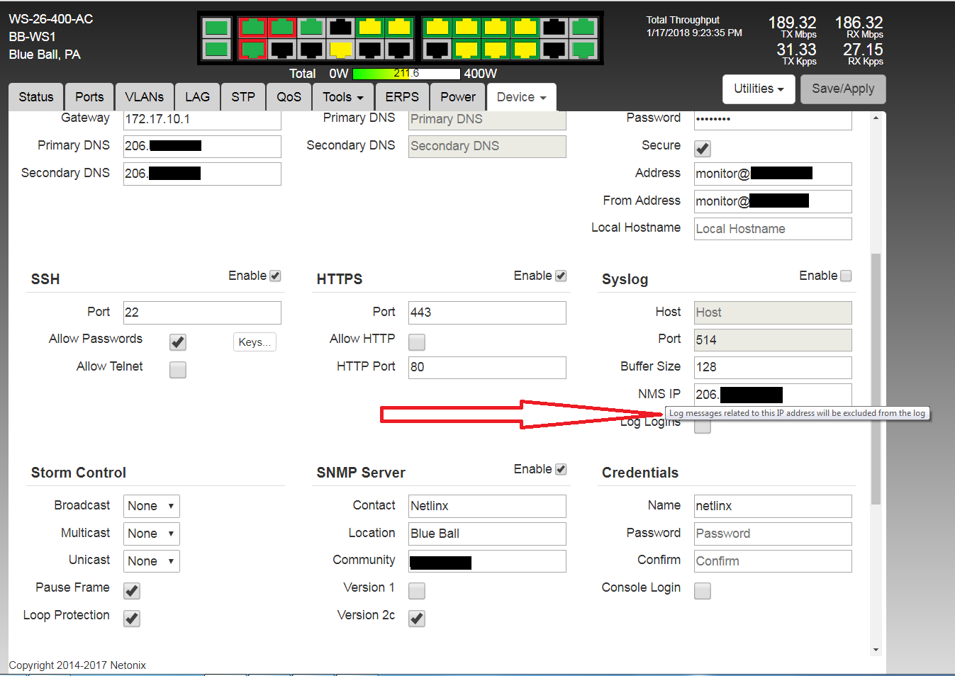

NMS IP field is exactly what it says, your Network Monitoring Server IP.
This way it does not log queries from this IP in the Log and fill up your log with connection entries every time your NMS server queries the switch.

People complained that the switch log was FULL of NMS Server queries and also why log that query to the SYSLOG server every time your NMS Server queries the switch which if you do this every minute that is 1440 log entries if polling the switch every minute.
NMS IP can be blank and it still logs to SYS LOG server. it does for me anyway?
Re: Syslog config question
If you would have moused over the "NMS IP" a balloon would pop up and explain what the purpose is for the NMS IP
Many items on the UI have mouse over balloons that pop up to explain things
