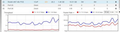

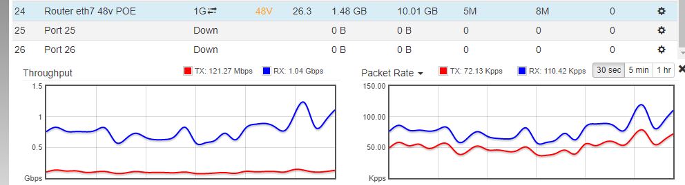

Hmm I get the 2x throughput deal, that's not the case here. I can click on the port that uplinks to our router and get this:
This is minutes after reset all the counters. I know 10GBs hasn't gone thru that port yet..

Re: WS-26-500-DC issues when SNMP enabled
The CPU utilization on the WS-26-500-DC is normally higher than any other model as the little MIPs CPU that runs the UI/CLI , stats daemons and other functions like reporting to SNMP, discovery, and so on.
You can disable feature on the Device/Configuration TAB and see what feature is using the CPU.
Disable things like SNMP, SMTP, Discovery and so on and see how each affects the CPU
Keep in mind this CPU has nothing to to with switch functions like packet forwarding and has nothing to do with load or capacity.
https://forum.netonix.com/viewtopic.php ... pu+#p22102
As far as the port reporting bandwidth passed has been investigated and verified many times? Since all the switches use the same switch core, same firmware, and so on the issue would be the same across all models if it existed? The switch core keeps track of these numbers and we simply pole and report these values and the switch core is a mature product and there are no bugs. That part of the code is written by the switch core maker not us.
If you look at the 1 hour graph for bandwidth it is a better representation of average throughput as you may be missing MANY spike that may have occurred that skew the bandwidth unless you sit there and watch that 30 second graph and pay close attention. But then again the 1 hour graph is a better representation of the overall average.
You can go to the CLi and drop to Linux shell and issue a "TOP" command and see where the CPU usage is being utilized and post a screen grab of the TOP command.
