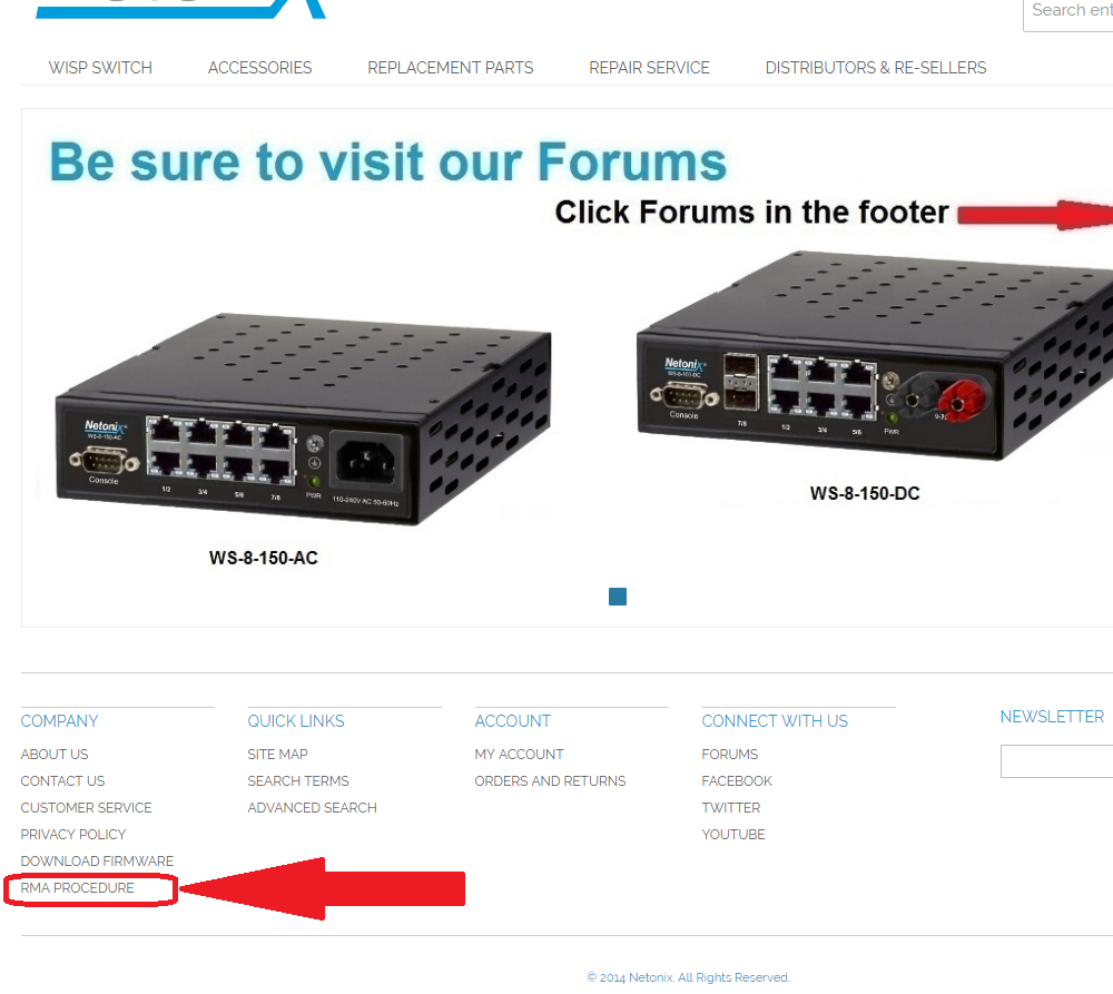

Re: WS-12-250-AC rebooting / dead
Thu Jan 11, 2018 3:43 pm
There is a link on the footer of our web page with RMA instruction.
