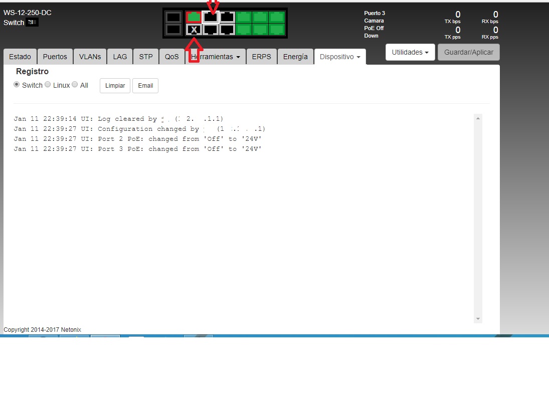

I found a bug After the update I can not turn on a port ie enable it from OFF to 24 in the registered one but the switch does not power the port

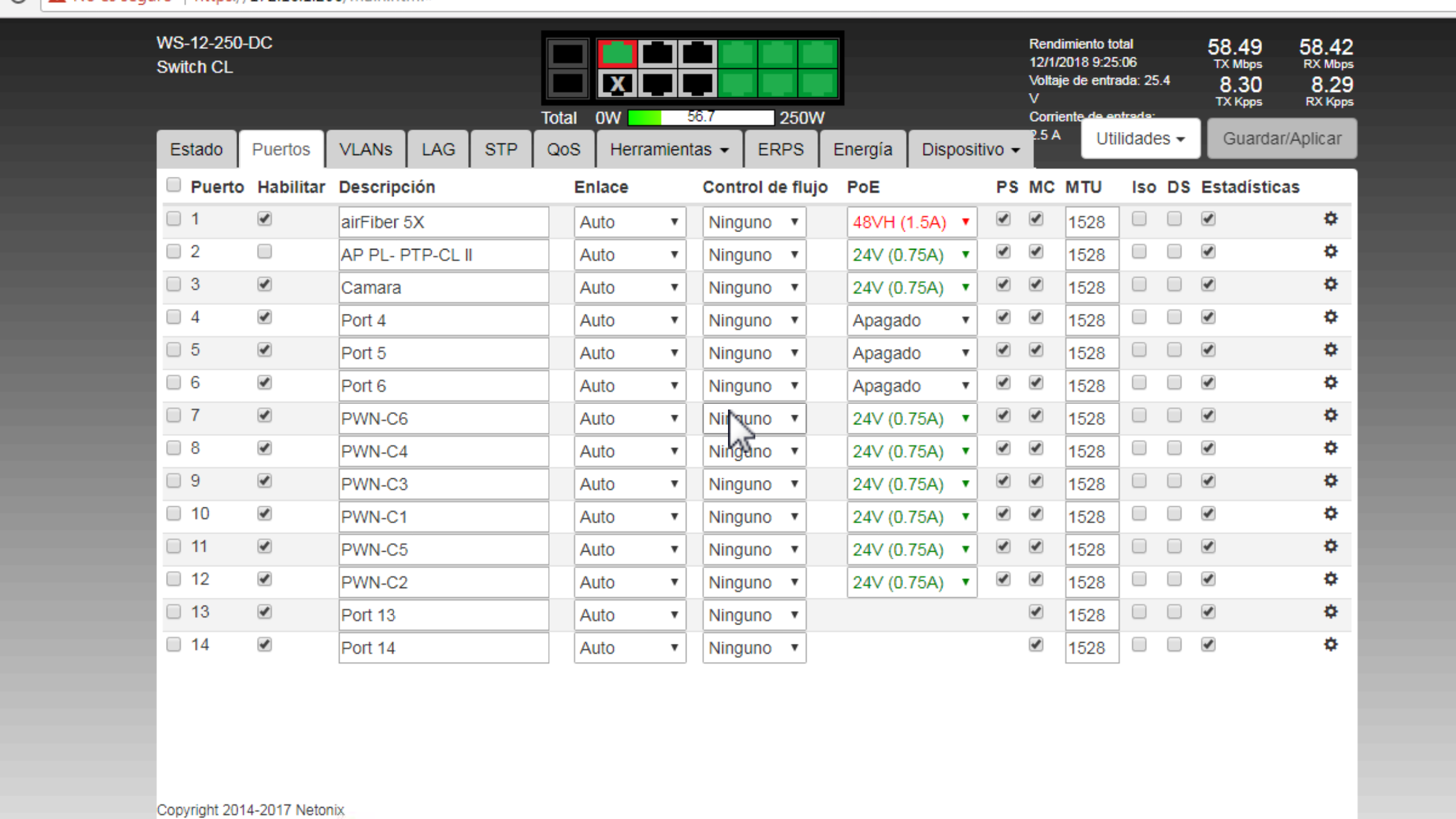

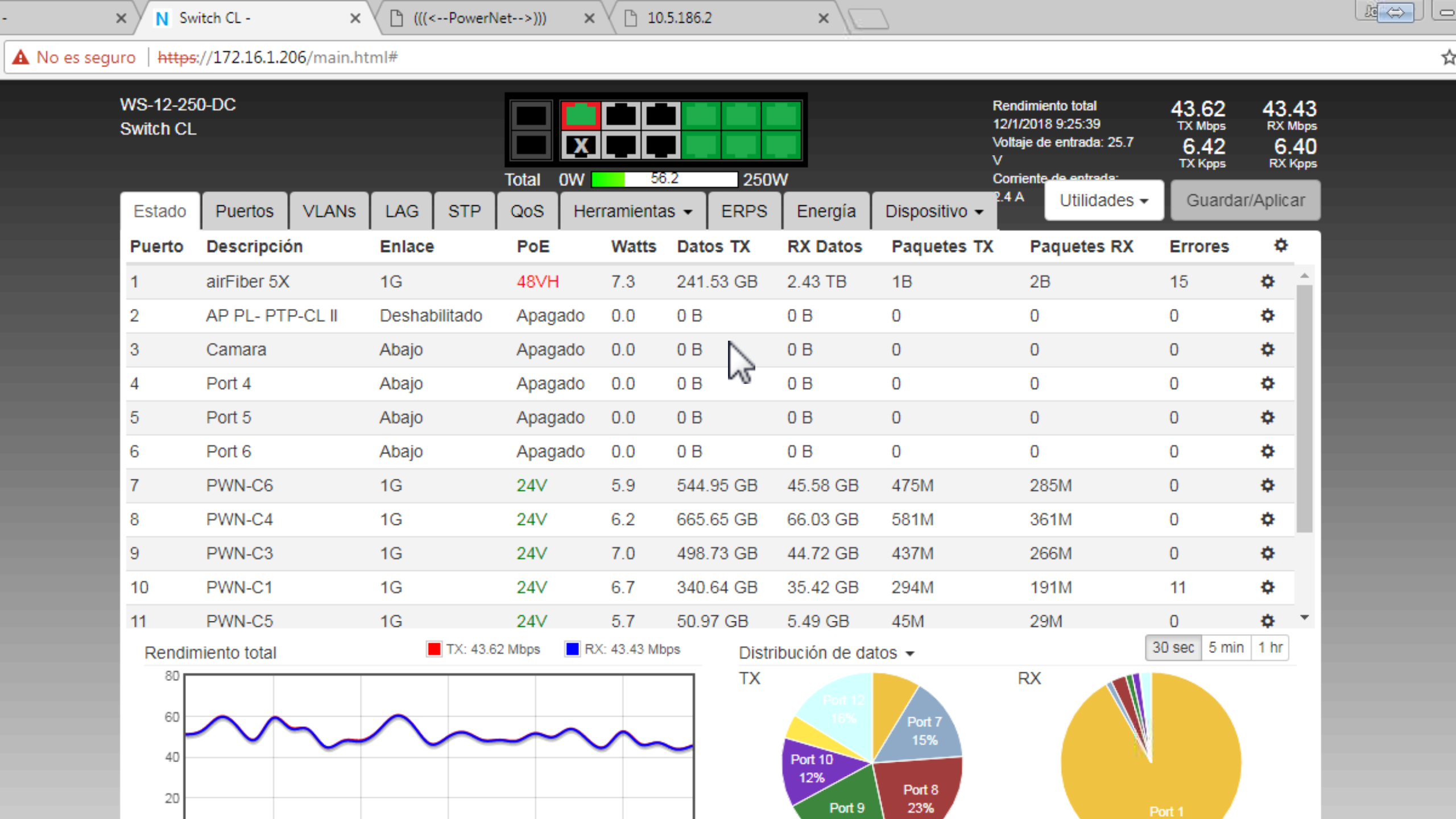

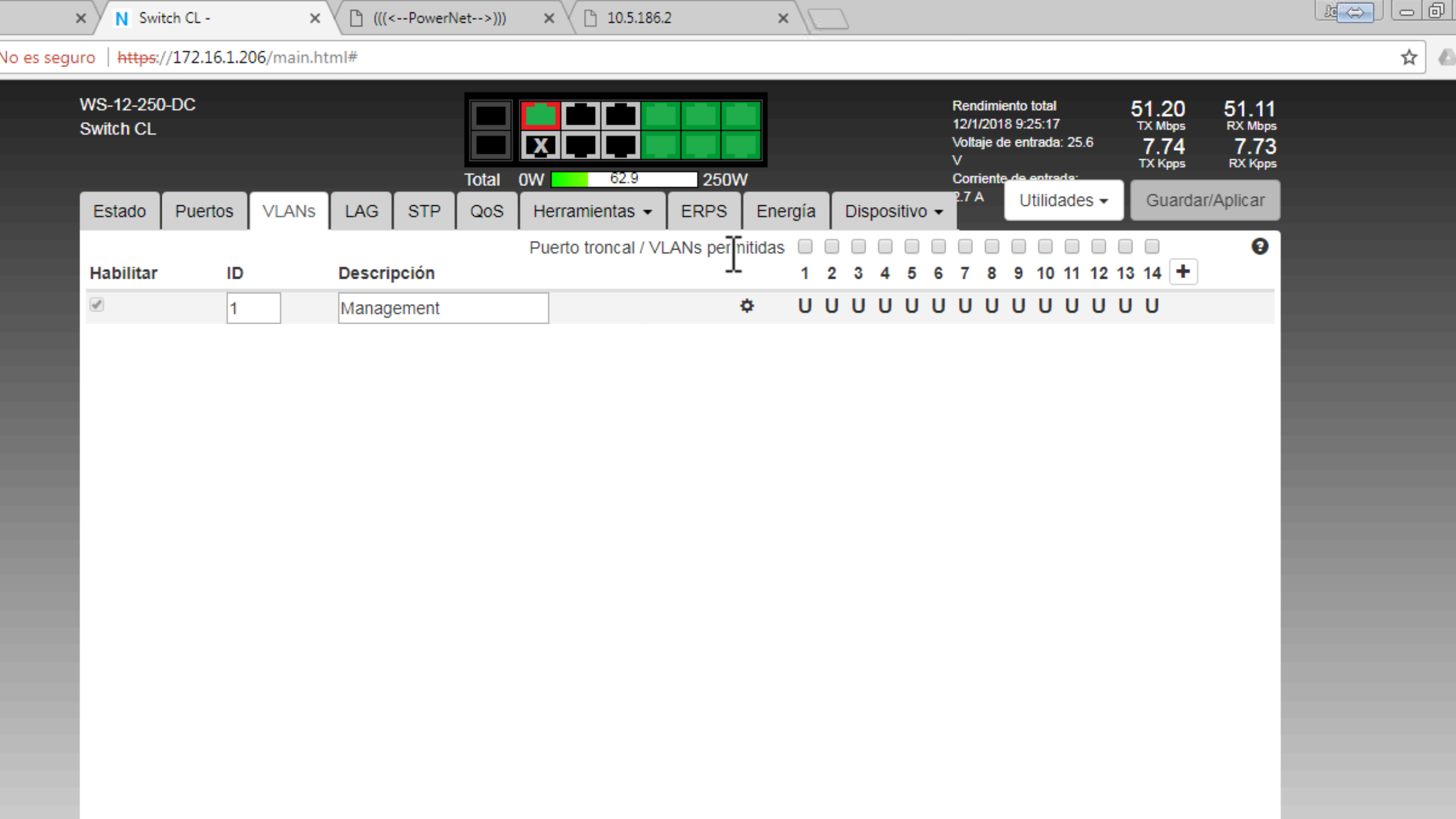

Please post up screen grabs of these TABs
Status
Ports
VLANs
Status
Ports
VLANs

sirhc wrote:Please post up screen grabs of these TABs
Status
Ports
VLANs
Hi, here's the picture you asked me

jg0007 wrote:I found a bug After the update I can not turn on a port ie enable it from OFF to 24 in the registered one but the switch does not power the port
You have red arrows pointing to port 2 and port 3 in your original post picture.
Port 2 has an X on it because it is disabled on the Ports TAB
