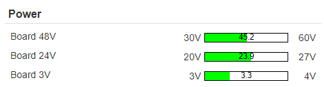

I have no free 48VH ports in my WS-10-250-AC. I needs to power a WS-6-MINI, so I connected it with 48 V.
I seems to work, but will it be stable or is it a no go ? (Plan is to upgrade WS-10-250-AC to WS-12-250-AC as it has 4 pcs. 48VH ports).
I will need to power 3 pcs. Rocket AC Prism Gen2 (24V) and 1 pcs. UniFi Outdoor (48V)....
I have 2 of the 3 Rocket AC Prism Gen2 turned on now.
Current power usage....
Will I run into problems ?
Powering WS-6-MINI from WS-10-250-AC with 48V

You don't actually show the current usage, just the voltage drop. It is not the voltage that is of concern but rather the current.
Re: Powering WS-6-MINI from WS-10-250-AC with 48V
lligetfa wrote:You don't actually show the current usage, just the voltage drop. It is not the voltage that is of concern but rather the current.
Exactly and since the voltage was 50V when it left the WS-10 and is only 45V at the WS-6 this is telling your that you have cable drop of 5V which would be less if using all 8 wires with 48VH instead of just 4 wires with 48V.
The more current you draw through the 2 pair (4 wires) the more voltage drop you will see which is loss and this is putting a strain on the center taps of the Ethernet Transformers.
Think of it this way, if you supplied water to a house with a single 1/2 inch pipe versus two 1/2 inch pipes. You would not notice a difference if you only used one faucet at a time in the house with just a single 1/2 inch pipe but if you tried to take a shower while someone washed their hands and another person flushed a toilet you would notice a significant drop in water pressure whereas the house getting water with two 1/2 inch pipes the pressure drop would be significantly less.
I would replace that WS-10 as soon as possible with a WS-12 and switch to 48VH to power the WS-6
sirhc wrote:Exactly and since the voltage was 50V when it left the WS-10 and is only 45V at the WS-6 this is telling your that you have cable drop of 5V...
Input diodes on the WS-6 will cause a 1.4V drop so cable drop is only 3.6V which is not that bad. Of course the unknown factor is cable length and/or wattage draw. I've seen 41.9V on a heavily loaded MINI and the cable was eating 10W.

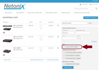

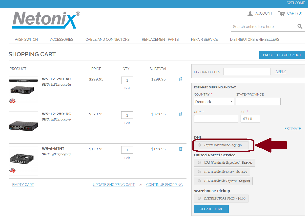

Because the ball was left in AVD's court, I explained this the last time you asked, somewhere on here is a copy and paste of the last email exchange with them.
You can always buy direct?
Since you are an Associate you get 10% OFF but you lose shipping discount on less than 4 switches or login with a non discount account and we discount shipping is your order is 1 to 3 units.
With 4 or more switches in your cart use your Associate account and get discounted shipping plus your 10% Associate discount.
As you can see in the picture below using a non discount account (MSRP) shipping on 3 switches from US to Denmark with DHL Express 3 business day is only $38.36 which is like $12.79 each for EXPRESS Shipping????
If your local Distributor does not carry it then order it direct and it is there in 3 business days.
NOTE: You have to pay VAT Tax but you pay VAT Tax when buying from a reseller in your your country. THere are also several other Distributors in Europe.
