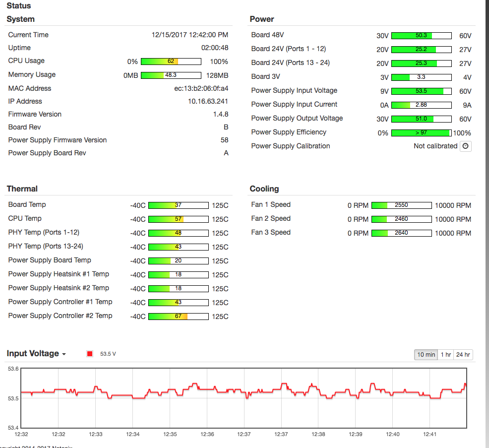

We have a new 26-500 rebooting every few days, It is DC powered by Ubiquiti Edge Power that is not losing power.
See attached Photo;

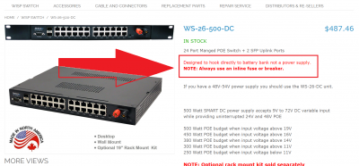

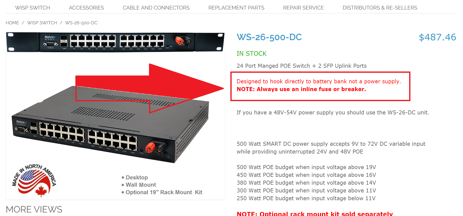

Why on Earth would you power a WS-26-500-DC with an Edge Power
WS-26-500-DC is designed to hook directly to a battery bank not to a power supply.
If your going to use a power supply buy the WS-26-DC which relies on an external power supply.
The WS-26-500-DC is 500+ watts, the Edge Power is what 300 watts (too small)
You want this model: https://www.netonix.com/wisp-switch/ws-26-dc.html
