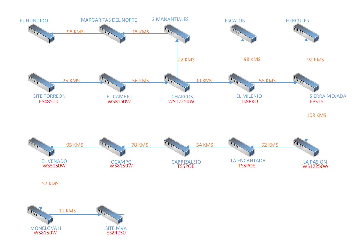

I have firmware 1.4.8 on ten Netonix switches and is the same problem.
Can you help me please?
Re: Netonix goes down with a "Discovery Device" Scan.
Please describe your network.
Is it a LARGE flat network?
How many devices on this Layer 2 segment?
- davidquezadaromero
- Posts: 5
- Joined: Thu Jun 29, 2017 2:55 pm
yes, Is it a LARGE flat network with six DC Netonix switches.
Network Topology:
Network Topology:
