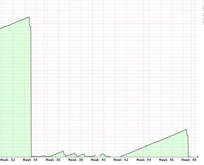

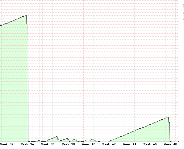

Here's uptime graph for site A with WS-8-150-AC switch.....
Start week 34 we started to see problems with the switch rebooting. It was swapped (switch no. 3), but problems was still there, switch rebooted randomly, Again in week 40 a new switch (no. 4) replaced the old.
In week 41 we found that grounding was not sufficient and fixed that. In week 41/42 we replaced again (switch no. 5) to make sure it was not the switch.
As you can see it ran without problems from week 42 til now where it suddenly started to reboot again....
That's why we don't expect the switch to be the problem, except if all 3 switches was from same batch (I actually don't know if they are ?)....
Switch 1 and 2 was replaced because of water in cable (Cable has been removed and new installed) 1½ years ago...
All cables has been checked for water, no water at all, cables are dry, so is switch/switchports etc....
Can you see from MAC address (above post) if switch is from bad batch ?
