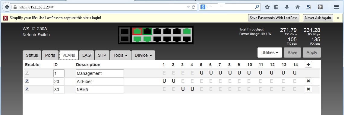

Posted: Thu Nov 27, 2014 12:28 am
Pleases post a pic of your vlan tab
I am positive that our VLANs are working properly as have tested the crap out of them and worked with many people using them in service.
If you read down through this thread you will see several VLAN config we have in service.

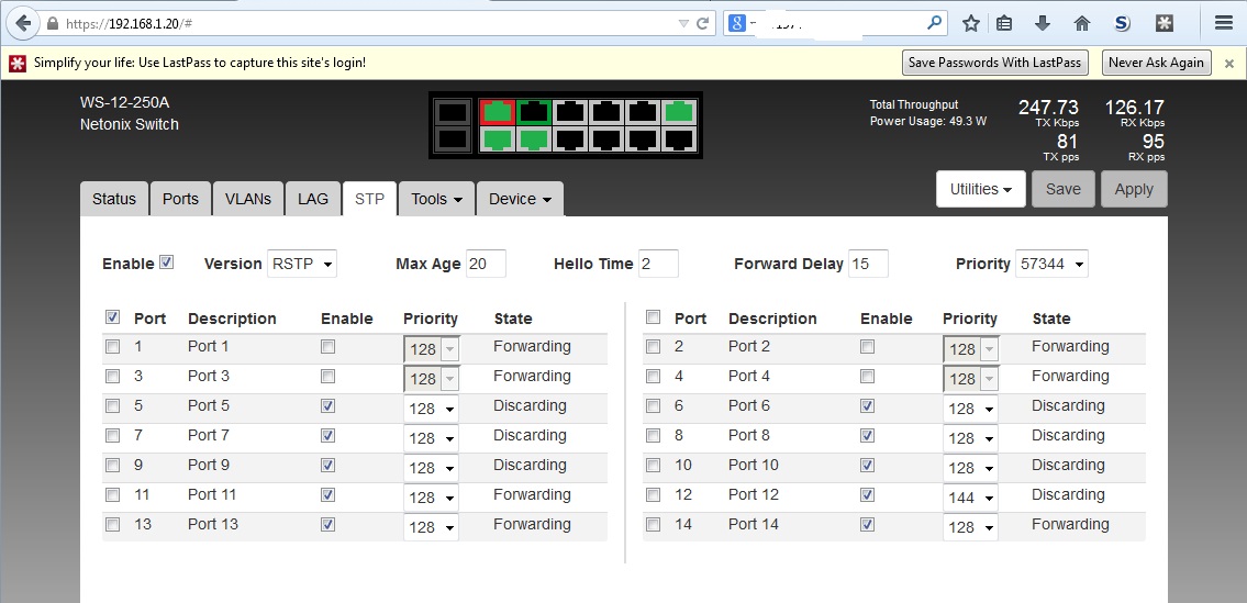

by LRL
Here's the screen pics.
Re: RSTP bug
Posted: Thu Nov 27, 2014 2:40 am
by LRL
I retested the initial problem with Loop Protection unchecked and the switch still acted the same. Removing the second cable doesn't bring the switch back. Moving one cable to a different port does bring the switch back *sometimes*. Other times I can't get the switch to come back without power cycling it.
