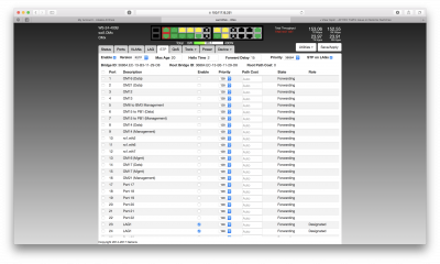

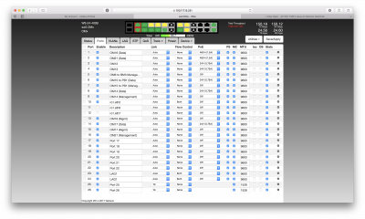

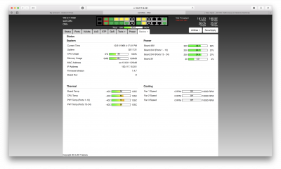

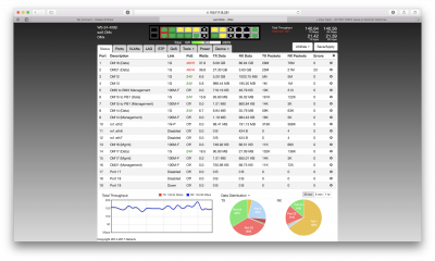

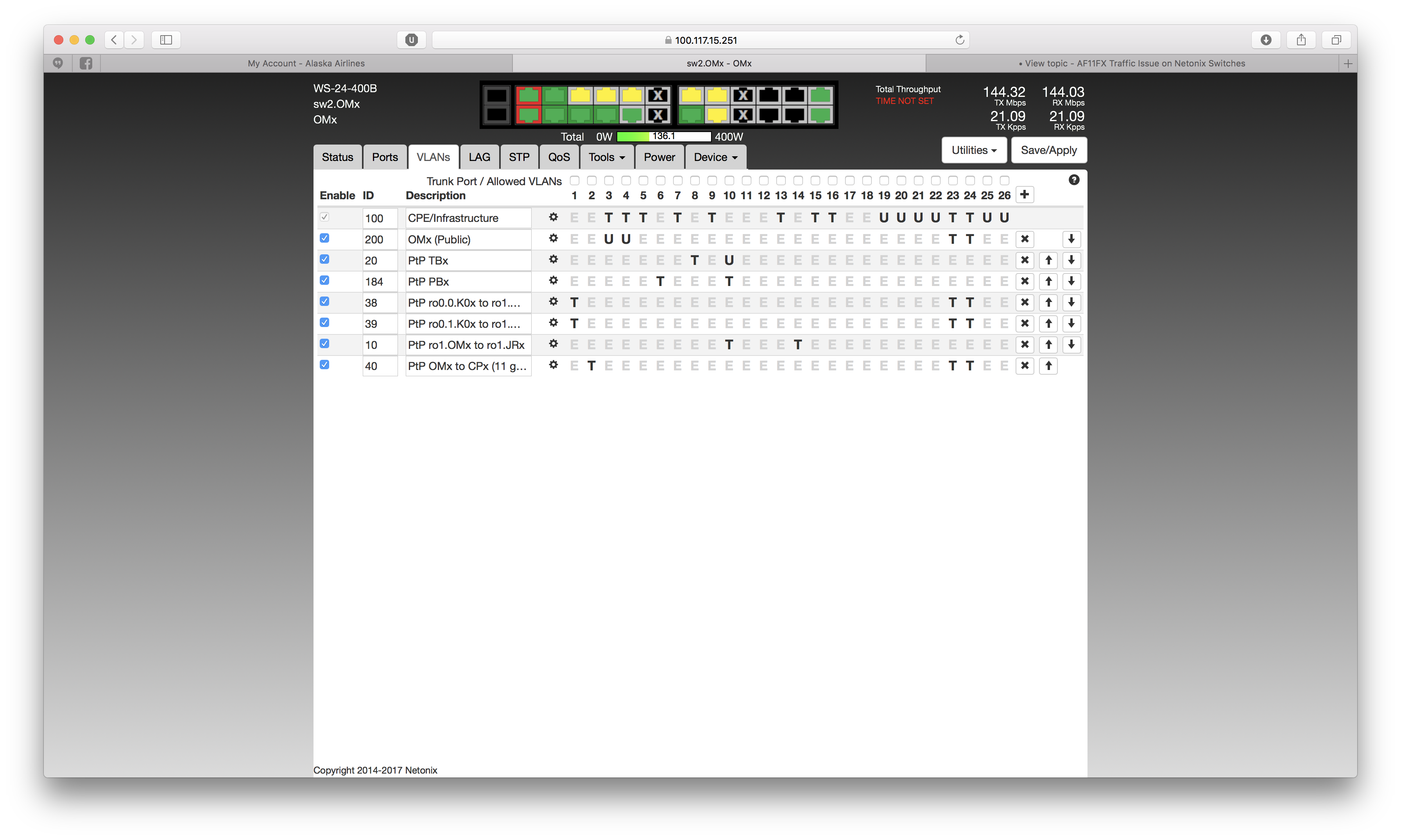

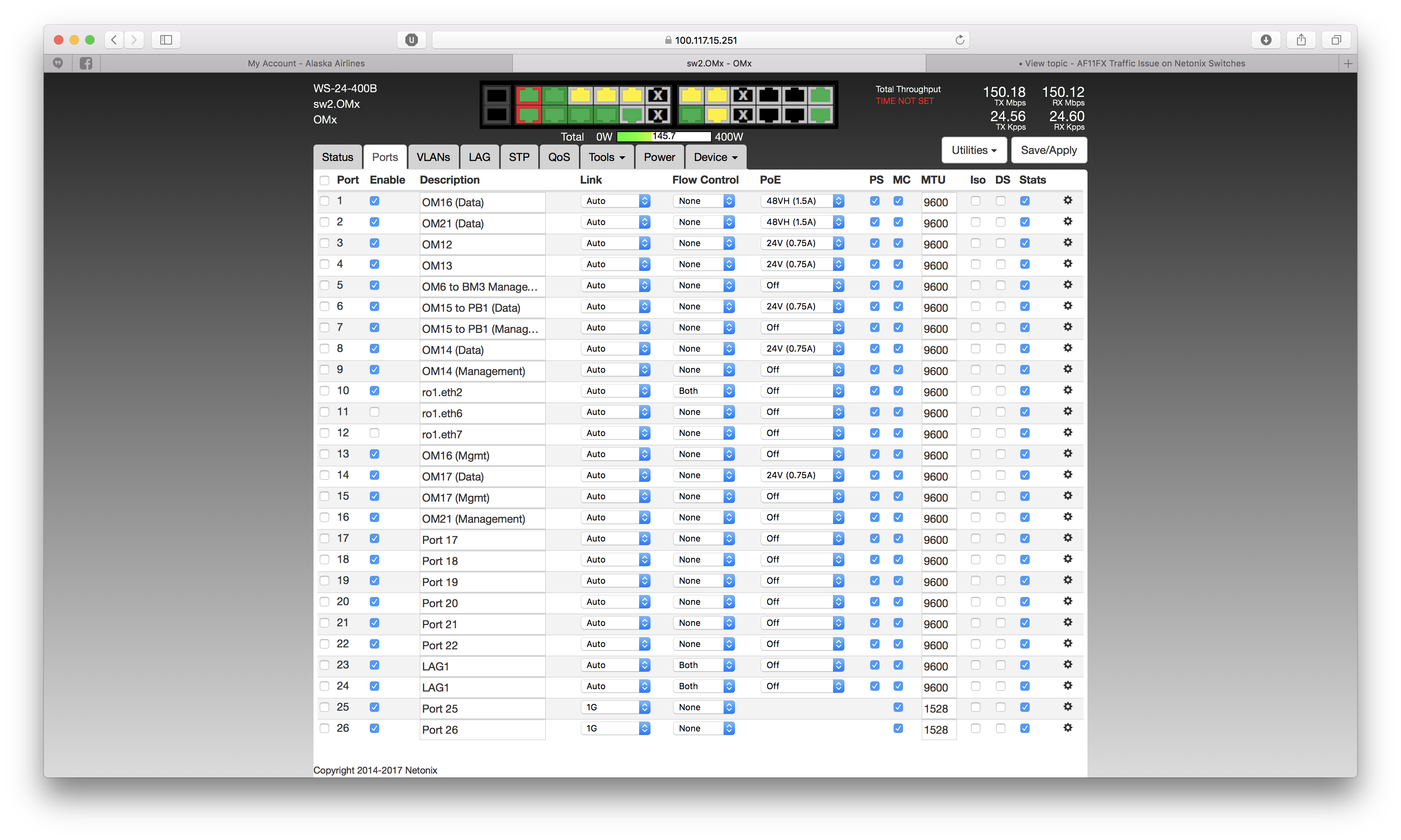

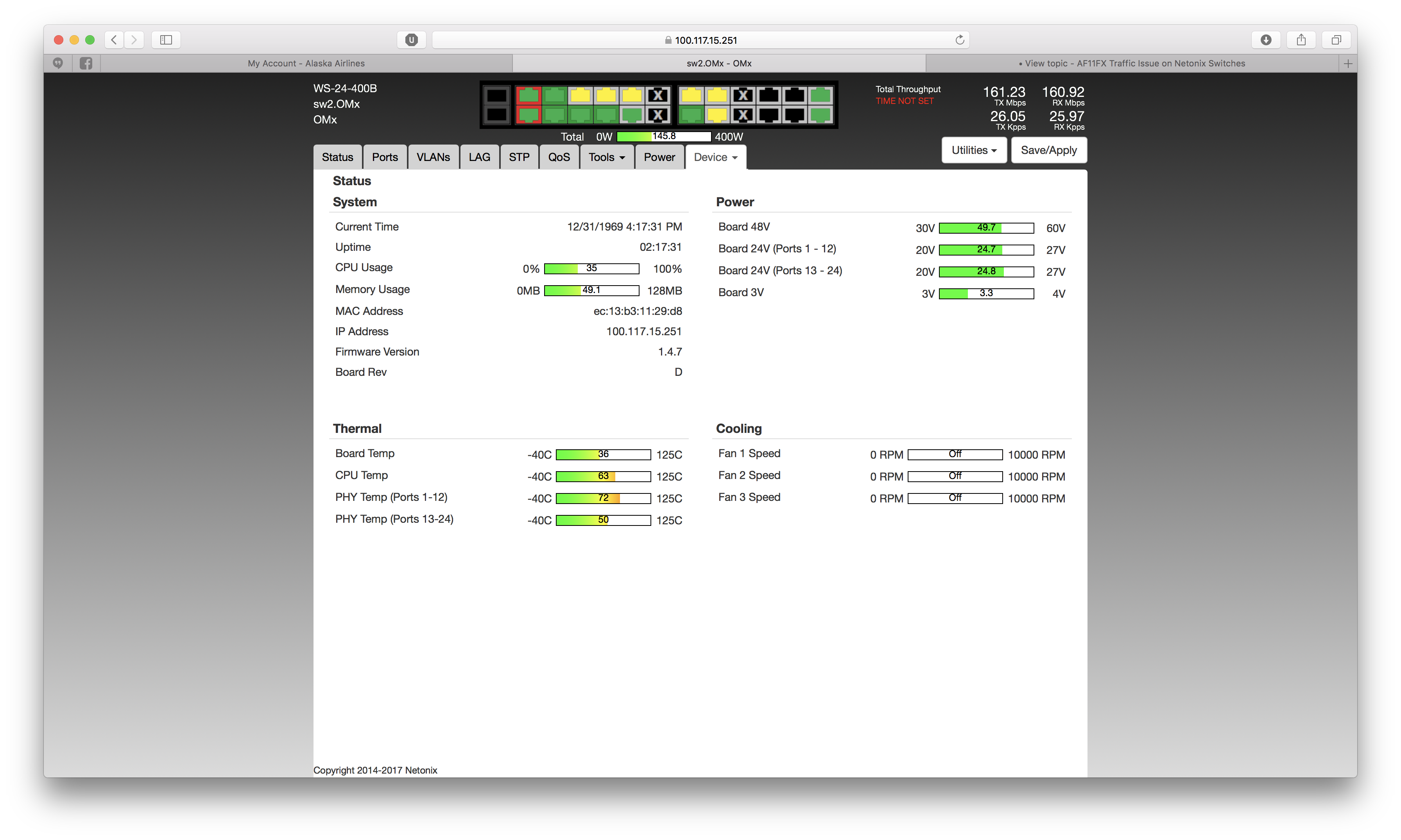

Hi Chris, sorry for the delay in getting these uploaded but here are the images you requested.
Status
Ports
VLANS
STP
Device_Status

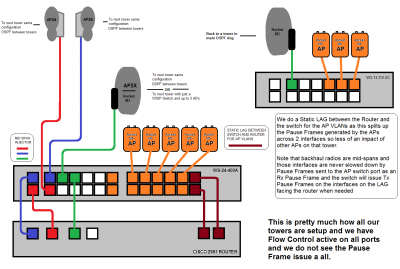

Re: AF11FX Traffic Issue on Netonix Switches
Thu Oct 12, 2017 9:40 pm

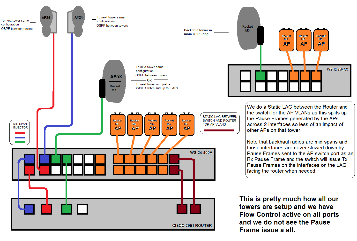

Please tell me what is on each port and its purpose.
From what I can see you are running all your radios through ports 23 and 24.
If you go look at my setup I separate each backhaul radios out into a separate 2 port midspan injector with each backhaul radios going to a single port on the router.
You do not want backhaul radios sharing ports in the router and you definitely do not want local tower radios sharing ports on the router with backhaul links.
Go back and look at my thread that shows my typical tower setup and also in the video I explain why each backhaul wants its own port in the router.
In my towers I make up to (4) midspan injectors with the following 2 ports for backhauls:
Ports 1 and 25 - Port 1 powers AF Port 25 with copper SFP goes to router port
Ports 2 and 26 - Port 2 powers AF Port 26 with copper SFP goes to router port
Ports 3 and 5 - Port 3 powers AF Port 5 goes to router port
Ports 4 and 6 - Port 4 powers AF Port 6 goes to router port
Then I create a STATIC LAG to my Cisco 2951 with ports 23 and 24 that service all local tower radios such as APs and private high end customer PTP links
This way Pause frames and other issues from local radios can not affect backhaul traffic coming into and out of tower and one backhaul can not affect another backhaul.
Backhaul radios should NOT share router ports

Port 1 is the AF11FX link that backhauls from this site (site B) to site A.
Ports 23 and 24 lag to another switch at this site.
The ospf ptp VLAN's are tagged on port 1 and port 23 and 24 to the other switch where they then are tagged on the router port that the ospf link exists on.
None of our router ports are shared between backhaul links and access point links. We do have a single port set up to handle both backhaul links from Site B to Site A. I will look into testing with each backhaul radio going to a dedicated router port though as well as watch through your video.

Also I wonder why WISPs would run jumbo frames?
The worldwide web is standard MTU of 1500 + needed overhead for encapsulation and in wireless a large MTU is not always a good idea because wireless retries cause more repeat air time.
