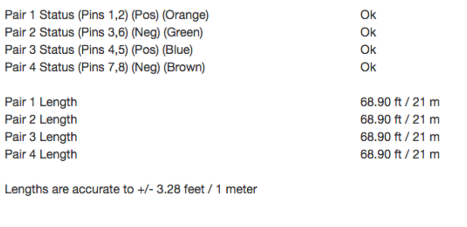

Here is a screenshot of the cable diagnostics:
Cable is just under 70 feet CAT5E. AF24 is on the 3rd floor commercial roof and WISP switch 12 port AC is in the 2nd floor utility closet.

In the future please upload screen grabs, instructions are in my post signature. I edited your post and uploaded the pic. The reason you do this is someday you may delete that pic from your site and will no longer be on the forums.
OK, I get that cable diagnostics reports fine but that does not confirm the port in the switch or the AF is not damaged.
Easiest thing to test is port in switch. Switch AF cable to another port and see if problem persists. If it does it is not the switch port.
