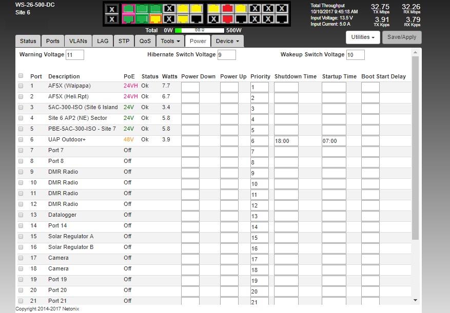

Can you post up your power tab also, the one that has the hibernate voltage settings.

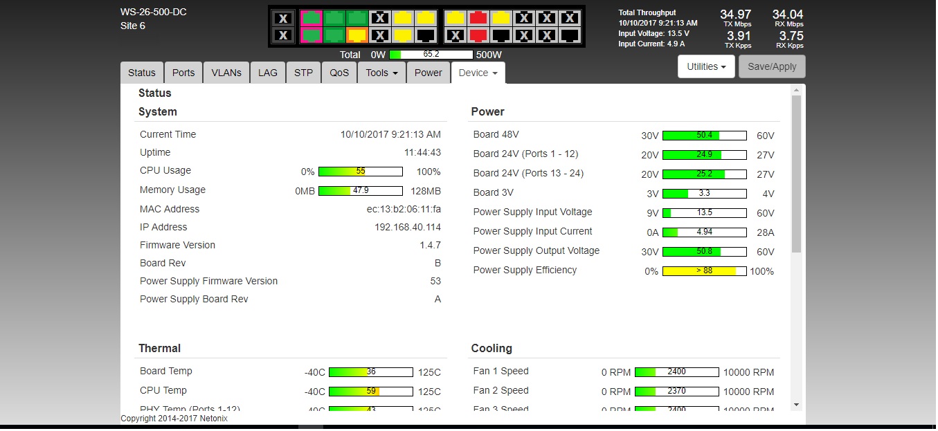

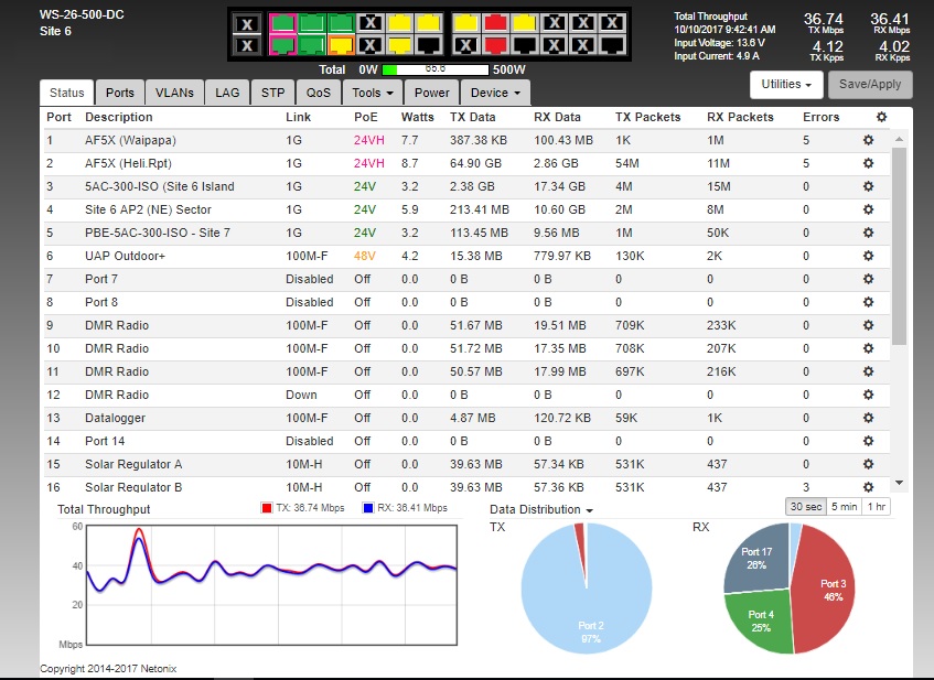

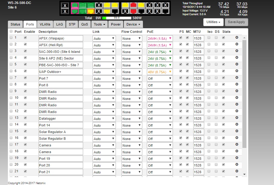

Post up screen grabs of the following TABs:
Status
Ports
Power
Device/Status

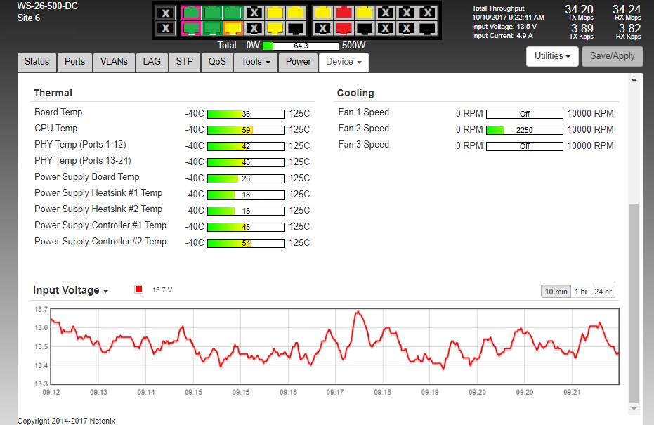

During the day the site is charged by solar. There is something like 12 or 1400 Ah of batteries connected in parallel at 12v and there is a generator that runs 12 hours over night every night. The switch runs from a 12v power distribution box which is connected directly to the batteries. It is not a power issues, there is a lot of equipment running out of the same distribution box that does not see this issue. Even the previous switch the WS-12-250-DC did not see this issue running the same firmware. I don't believe we have added any extra POE devices since upgrading the switch, it has only had non POE devices added.
I agree that it would be better at 24v how ever there is equipment on this site that requires 12v. Yes I could step up the voltage but your switch can handle 9-72v I shouldn't need to run extra voltage equipment. As I keep saying the 12 port switch was perfectly fine. I have management of 50+ netonix switches on both 12v and 24v systems yet this is the only switch I am having problems with. I believe it all points to this particular switch. Now I do not know if it is hardware or software issue hence I am posting here.
My boss is always doubtful upgrading firmware to anything other than listed as a stable release. How ever if you are confident the latest RC firmware is stable enough I can look at running it. This switch is linking DMR radio repeaters together so it is paramount there is zero issues as it provides communication and emergency radio comms into areas there is no cell phone coverage.
Please see attached screen shots as requested.

If the power supply controller chip gets too hot it will shut down, in the FIX it kicks the fans on to prevent this.
I know you say the previous switch used the same "transfer" box but the 500 is a bigger power supply with a much bigger possible draw and inrush than the 250. We designed the switches to hook directly to the battery bank with nothing in between except maybe a fuse.
