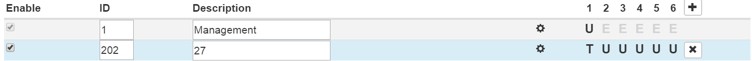

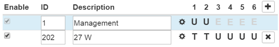

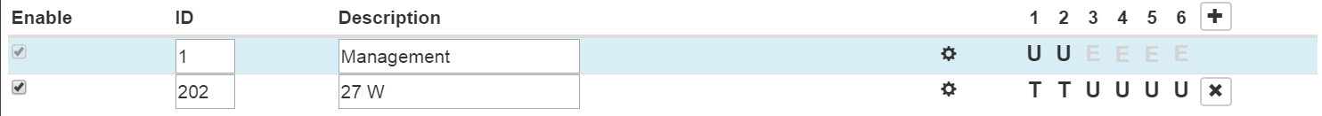

When we leave port #2 tagged with both VLANs no traffic will pass on the untagged ports 3-6. If we untagg the port #2 to the same VLAN as port 3-6 all seems fine. Ideally we want all VLANS tagged on ports 1-2, and one vlan untagged on 3-6, seems this configuration isn't working. Odd right? Here are some examples.
VLAN Not passing on 3-6
VLAN Passing on 3-6
VLANs not passing in some configs on the WS-6-MINI

Ports 1 and 2 will accept 2 type of ingress packets:
1) Untagged packets which will be directed to the switch UI/CLI only as defined in the Management VLAN (The one VLAN definition that is always at the top of the list)
Untagged packets entering ports 1 and 2 can NOT egress or exit ports 3,4,5,6.
But untagged packets can ingress and egress between ports 1 and 2 freely.
You can renumber or rename the Management VLAN but it is always at the top of the list and the only VLAN matrix definition that has access to the switch UI/CLI
2) Tagged packets with VLAN ID 202, any other VLAN ID tagged packet will be dropped or refused trying to ingress on ports 1 and 2
Ingress packets on ports 1 and 2 with VLAN ID tag of 202 will be available to exit ports 3,4,5,6 having their VLAN ID tag (encapsulation) stripped on egress of those ports and become a normal packet with no encapsulation.
Only normal untagged ingress packets on ports 3,4,5,6 will be accepted all others will be dropped or refused. Untagged ingress packets entering ports 3,4,5,6 can not get to the switch UI and can only egress on ports 1 and 2 as encapsulated VLAN packets with a VLAN ID tag of 202. (the packets are encapsulated on exit of ports 1 and 2 with VLAN ID 202)
So the only way to get to the switch UI would be through ports 1 and 2 as untagged packets, untagged packets entering ports 3,4,5,6 can NOT get to the switch UI/CLI.
Tagged packets with the VLAN ID of 202 ingress on ports 1 and 2 can only egress out ports 3,4,5,6 as untagged packets

With the way you have your VLANs setup as below I have described how packets will be handled.

If VLAN pass when untag on port 2 but won't pass through when tagged on port 2, that mean your vlan is not tagged on the device plugged on port 2 (so traffic is untag).
But if it stop on untagged ports, like you writed, that mean that you can't ping between untagged ports (between 3,4,5 and 6) ? Is that what you mean or only between 2 and the untagged ports ? If it's ping between untagged ports but not between tagged 2 and the untagged ports, that mean the traffic that enter port 2 is not tagged with VLAN 202 so dropped by the switch.
