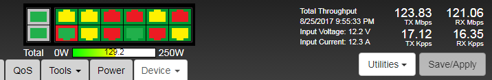

Anyone ever seen this before? Everythign is working great, then suddenly the switch downgrades nearly all links. Links at 1g go to 100 and links at 100 go to 10. Links restore to their prior state, but at that point spanning tree freaks out and leaves several ports in the discarding state. Below is the log, any help would be appreciated.
I should also note that the switch refuses to take config changes after it happens. I can't bounce a port, turn poe off or reboot/reload from software. The only fix is to physically power cycle it.
ws-12-250-dc running 1.4.7

Switch downgrades links all at once
-LRL
