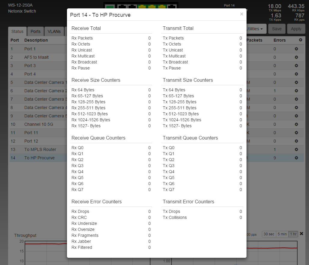

Today I received two copper SFP's which are both working fine as far as I can tell in my WS-12-250A. The two models I bought are a NCOM GLC-T and a Long Line GLC-T-LL.
Neither these SFP's or any of the other optics I've tried ever show anything under the "port detail" tab on the status page. All zero's. The main page shows stats for all ports (even the SFP's). Any idea why there is nothing showing up under the port detail button?

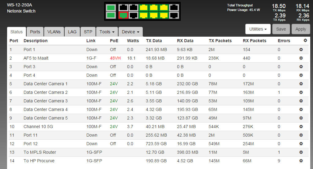

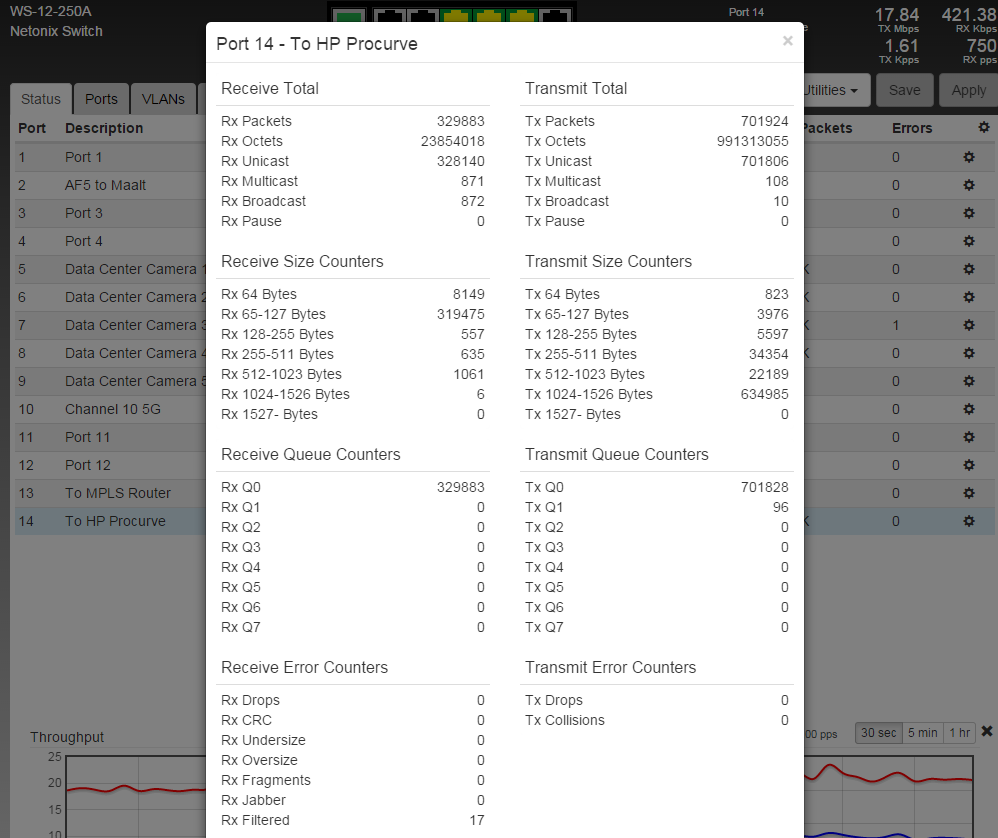

Here are my port detail and status page with two copper SFP's
I assumed the same thing with the patch cables so I order more.
But if I take the sfp and cable out of the WS and use them between two mikrotik's it works fine.

Re: Copper SFP's
I sent this to Eric to investigate, hope to get back to you soon
Re: Copper SFP's
OK I just posted v1.0.6rc1 which fixes the port details on the 12 port switches.

Re: Copper SFP's
Just updated, and yep, port details work on both copper SFP's.
