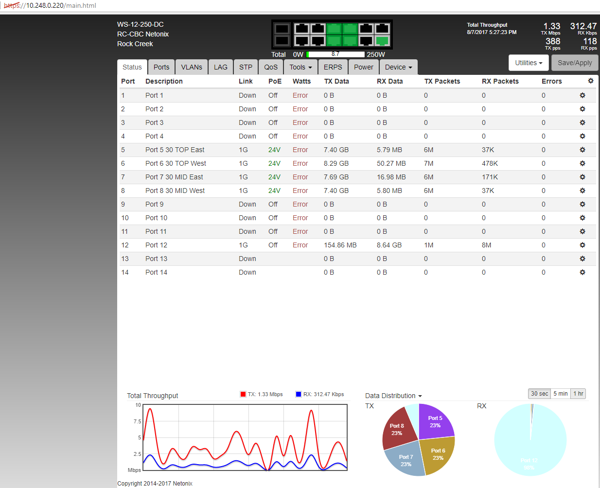

WS-12-250-DC with 1.4.8rc7 installed July 7th with a simple config has been running perfectly until this morning.

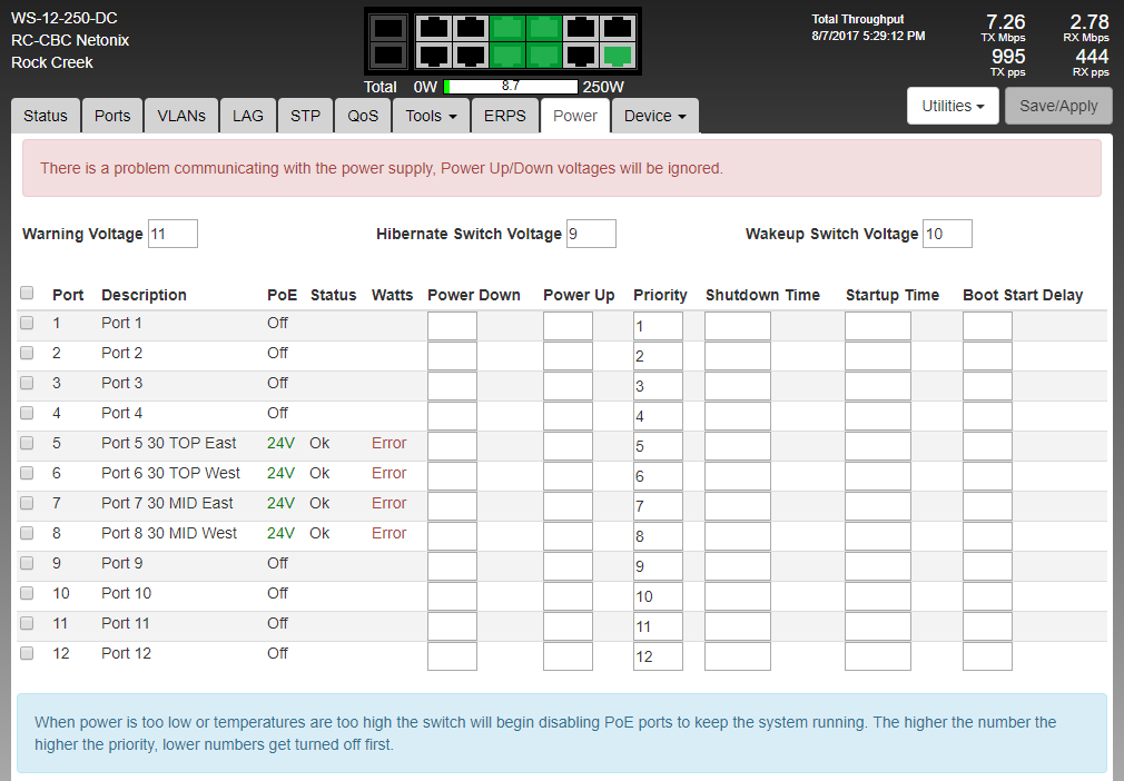

This AM I found the switch sending these email alerts (about 40 of them between 1am and 8am)
"Low voltage warning (11.0V) - from RC-CBC Netonix (10.248.0.220)"
The switch is powered by 12v battery. The battery is full.
The switch appears with a red ball in the Netonix Manager with the status "Invalid username or password"
The username and password is correct tho, its been reporting fine since it was installed.

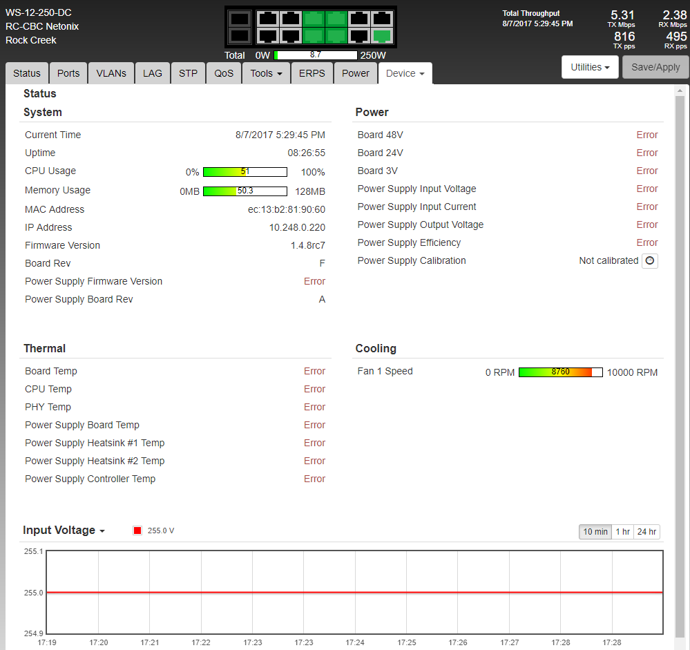

The log (attached) is filled with this:
Aug 7 16:27:12 switch[934]: retrying i2c link to power supply
Aug 7 16:27:15 switch[934]: retrying i2c link to power supply
Aug 7 16:27:18 switch[934]: retrying i2c link to power supply
Aug 7 16:27:18 dropbear[1173]: bad password attempt for 'admin' from ::ffff:66.244.241.105:52447
Aug 7 16:27:19 dropbear[1173]: Exit before auth (user 'admin', 1 fails): Disconnect received
Aug 7 16:27:21 switch[934]: retrying i2c link to power supply
Aug 7 16:27:24 switch[934]: retrying i2c link to power supply
Aug 7 16:27:27 switch[934]: retrying i2c link to power supply
Aug 7 16:27:28 dropbear[1197]: bad password attempt for 'admin' from ::ffff:66.244.241.105:52526
Aug 7 16:27:29 dropbear[1197]: Exit before auth (user 'admin', 1 fails): Disconnect received
Is there anything I should do before rebooting?
This is a remote switch.

I should add the switch is passing traffic and powering 4 Miktotik APs right now
Re: I2C Failure and more
Power cycle the switch (10 seconds no power), if that does not solve the problem then you need to RMA it because it is either failed or damaged.

Visited the site today, found a bad power connection for this switch near our fuse block. A connector had come apart on us and there was no more than a pins head size of contact area on 12v positive line in ..
