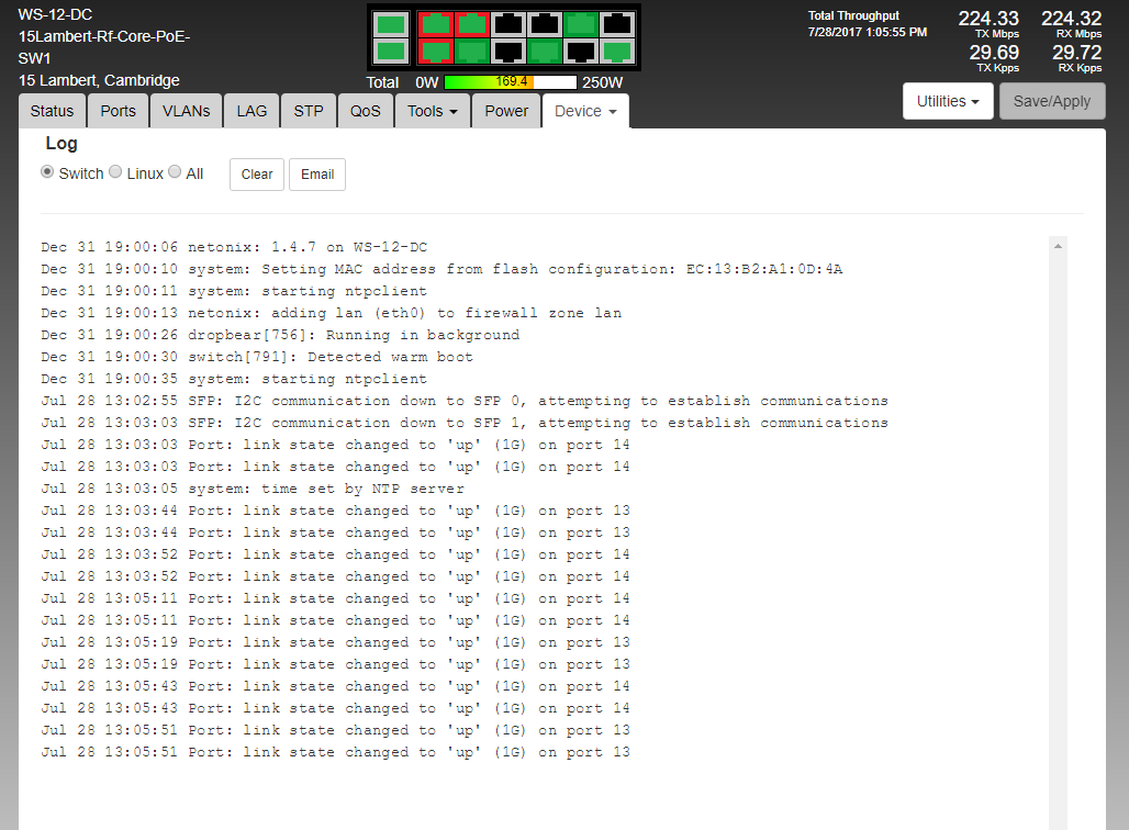

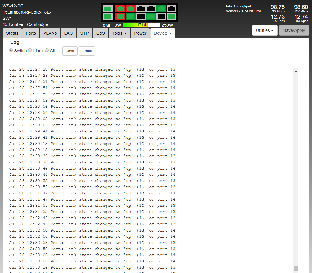

Running 1.4.7. Started getting packet loss, which I've traced to switch ports flapping. One peculiar thing is the log only mentions ports going up, never down, and yet packet loss suggests this is real. Logging into the switch, it looses communication with the upstream router for a second or so several times a minute. Ports 13 & 14 are the connections to the upstream router (vlans to different radios divided between ports, but management via either). The upstream router is a MikroTik CCR1036-8G-2S+ and it thinks the two Ethernet connections to Netonix SW1 are stable and have been up for days. Yet clearly traffic stops flowing for a second or so several times a minute.
What's going on?
Log shows link repeatedly going up but never down

Rebooting the switch has not fixed the problem but the new log entries show a delay in establishing I2C communications with ports 13 & 14:
