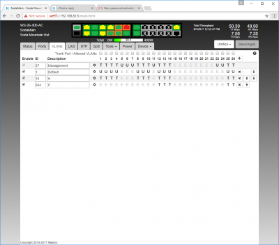

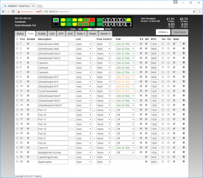

Duplex is Auto.. Images attached. Everything else is pretty much defaults.
