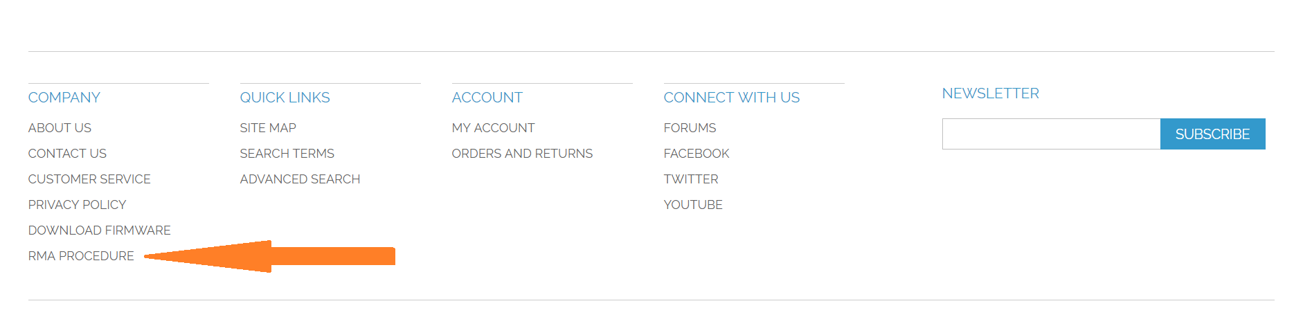

At the top of each forum there are announcements and below them are sticky posts, all of them are important posts to read.
This is the RMA announcement post: viewtopic.php?f=6&t=1259#p9343
The footer of our web page also has links to special posts:
