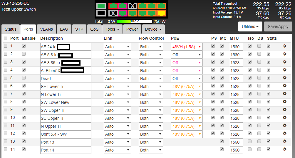

We have been using the WS-12-250-DC switches for about 18 months. We have had very few issues until the last two months. I have received separate report from two of my lead techs that when they reboot the switch it will burnout one of the POE ports it is currently using. When they program a new port the device will power-up and work fine. At this point I have at least 5 WS-12-250-DC in the field with dead ports.

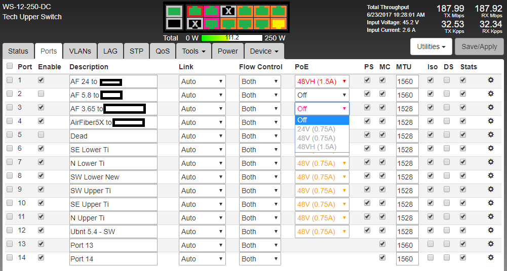

Today I also took screenshot of the following bug.
Please let me know what additional information your require.
