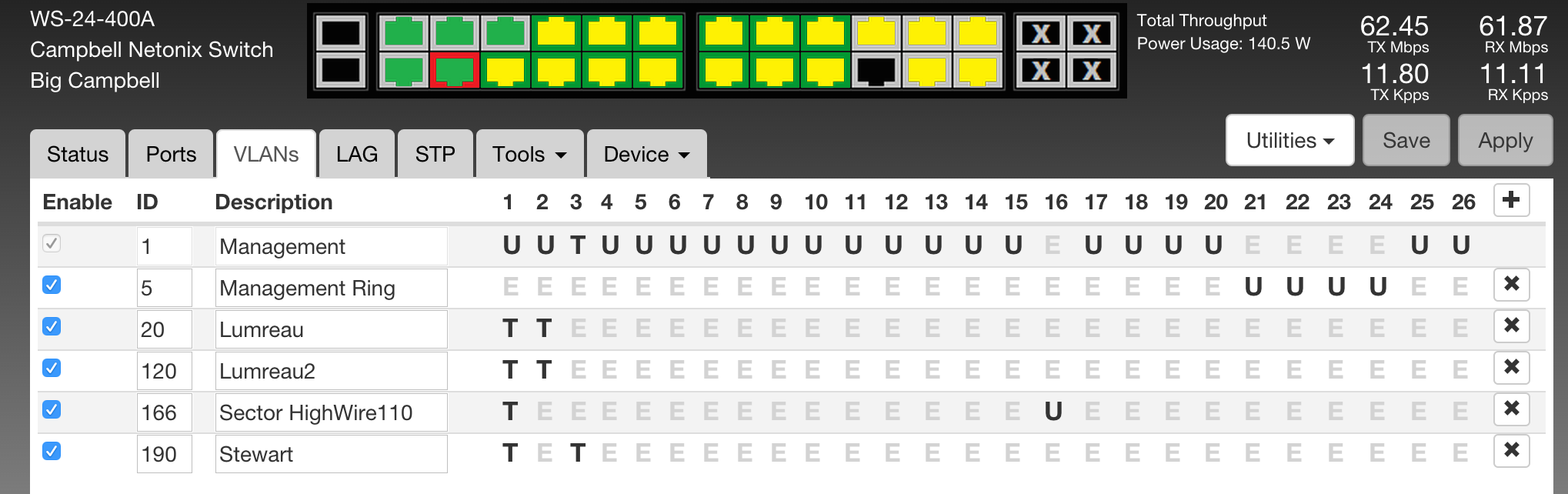

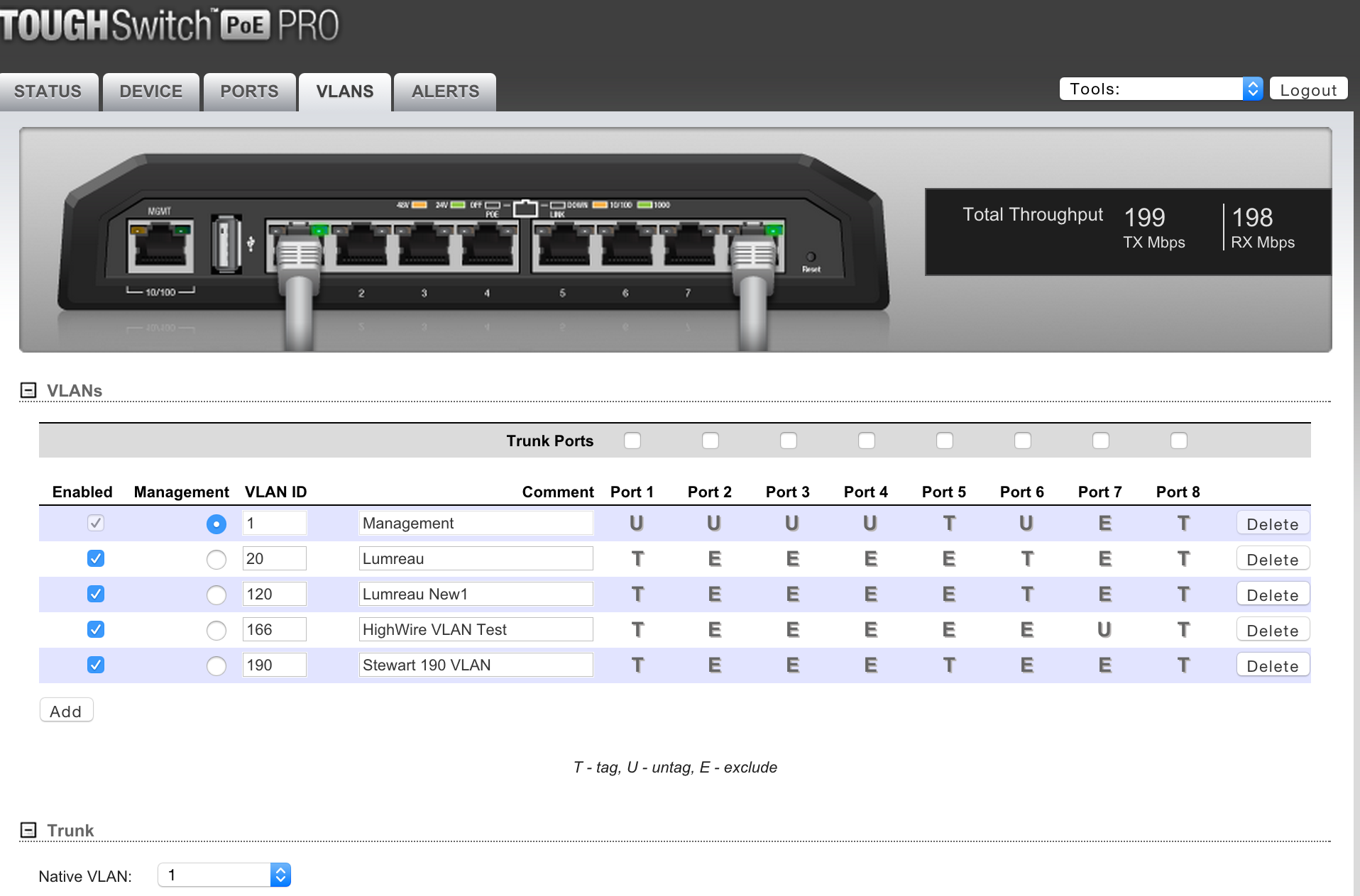

Tried to replace four ToughSwitches on our busiest tower with a WS-24-400A and unfortunately ran into some trouble on the VLAN front. For whatever reason things seemed to work OK when using the ToughSwitch in a configuration where port 1 is connected to a device with the following configuration:
VLAN 1: Tagged
VLAN 20: Tagged
VLAN 120: Tagged
VLAN 166: Tagged
VLAN 190: Tagged
With VLAN 1 set as the Native VLAN on a trunked port.
When configuring the WISP Switch, I noticed that it didn't seem possible to configure a port for both a tagged and untagged VLAN on the same port. In other words, it doesn't appear possible to have a native VLAN that is the same as what is already set as a tagged VLAN when a port is set as a trunk port. We hoped it would work configuring the port as VLAN 1 tagged, but no go. Tried VLAN 1 untagged and had the same result- no go.
In the end, this forced us to use the ToughSwitch as an intermediary device so that one port of the ToughSwitch was configured as stated above and connected to the uplink device the other port fed the WISP Switch with the same configuration stated above except that VLAN 1 is untagged on the port connecting to the Netonix. Once I did this, everything came up and worked on VLAN 1. Prior to this, only the other VLANs passed traffic.

As I shared above, I currently have one of the old ToughSwitches in place between the Performant device and the WISP Switch. Port 8 on the ToughSwitch is connected to the Performant device and Port1 of the ToughSwitch is connected to Port 1 of the WISP Switch. This had to be done to allow the WISP Switch to pass traffic on VLAN 1 to the Performant gear, which is connected to our backhaul radios. On the other side of the backhaul radios, there is another Performant device that connects to an EdgeRouter where VLAN 1 is untagged and the other VLANs are tagged. This would make me think that the WISP Switch could be configured the same, but it does not work and only seems to work on the ToughSwitch with the config as described.
Here are the relevant screenshots:

Have you tried setting the wispswitch up more like the toughswitch? With Vlan 1 set to T on the trunk port (port 1) instead of U? Apologies, I just want to confirm that you have tried that and it did not work.
I will be able to verify this configuration a little later tonight / tomorrow AM, so if there is something weird on my end I should hopefully be able to find it. I know I have tested similar and it worked at the time, but sometimes there are regressions on newer code, so there is always the possibility that it may not work now.

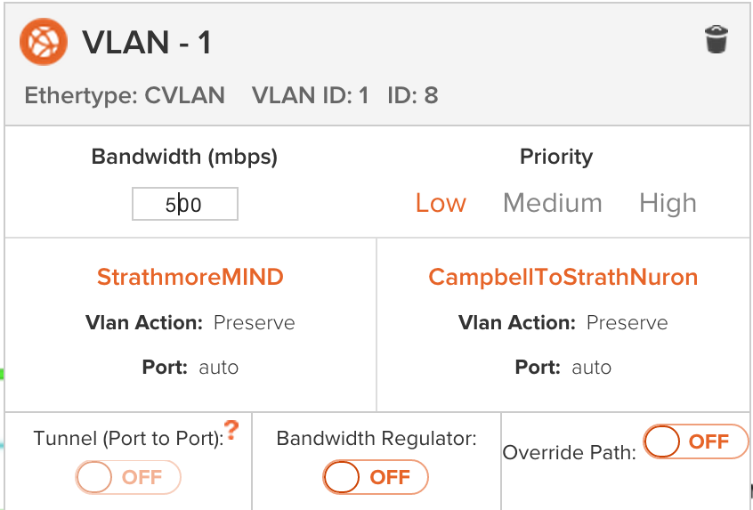

I noticed that your performant gear says "VLAN ID:1 ID:8" Do you know what that means? I tried googling their page, but all I get is a 'page cannot be displayed' for their store when I attempt to access any links to their site at the moment.

Yes, I tried the WISP Switch with VLAN 1 set to both T and U when connecting to the Performant device and neither worked.
The ID:8 is something internal to the Performant though I am sure Matt and Josh would be better suited to answer that. Some kind of mapping between C-Tags and S-Tags. I think I had it explained once to me, but haven't had to dive back in for a while. Its probably in my notes somewhere. My understanding is once the VLANs are handed off from the Performant gear, they act as any other device and it is just the VLAN ID that gets passed... in this case- 1.

by josh
ID # is just an internal "row" number the vlan is mapped to, that's it. It has nothing to do with VLAN ID. Basically saying "this is the 8th vlan you've made on this device"
