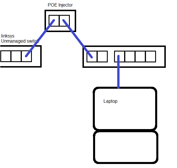

Re: New WS-6-Mini Owner Needs Help
How big is your IP class? (what is your sub net)
How big is your Layer 2 segment? (how many devices on this network segment)
Is this is what you have set up?

Yes; that is my exact setup.
