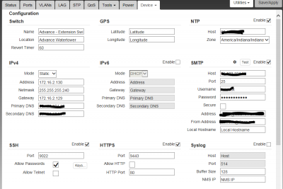

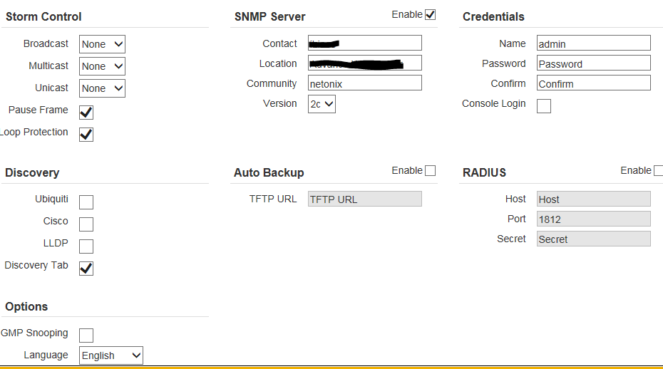

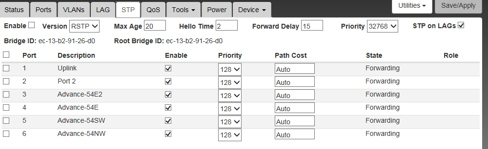

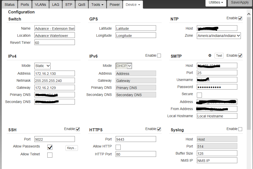

First I will post my config as requested by Chris.
WS-6MINI Lockup after swapping AP?

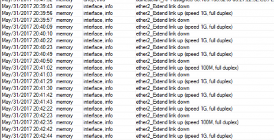

Well it took almost 5 hours but the switch locked up again. So the issue is not caused by having an AC AP in port 5.

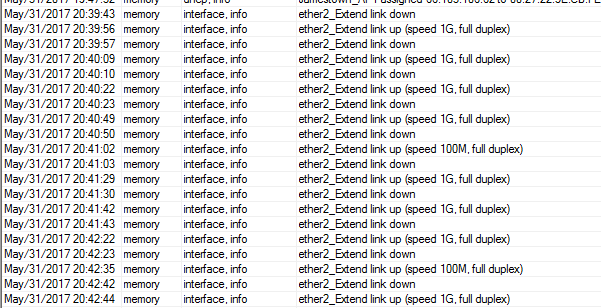

This time the switch was locked up for 5 minutes and then rebooted itself. Here is what my tower router showed on the interface connected to the switch during the last lockup.
At this point I still plan to replace the switch and power supply to hopefully figure out if it is the switch or not that is the problem.
As it is almost dark here my issue now becomes is it stable enough to wait until tomorrow morning to do the replacement or not.
If it can got about 4-5 hours between lockups then I think I can wait till the morning. If it starts doing it every 30 minutes again I guess it will be time to get out the head lamp and climb.

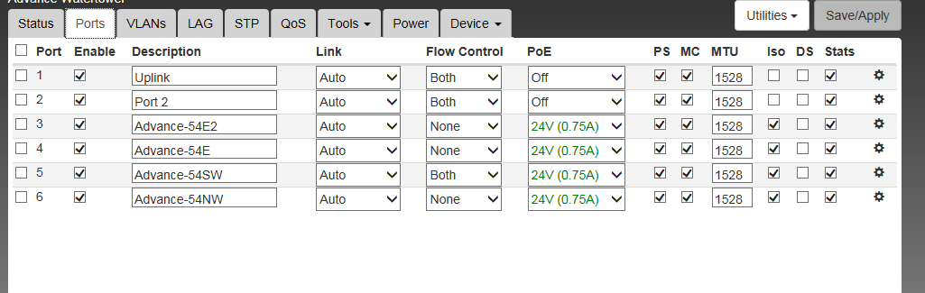

In a possibly vain attempt to stabilize the switch I have set port 6 (54NW) to auto 100m negotiation. My thought is that before today both ports 5/6 were 100M due to using Rocket M5s that could only do 100F. As the new AC radios can do 1G on the PHY interface maybe there is more power draw at 1G on the switch and setting back to 100F might stabilize it until tomorrow.
Now I do not know what PHY chips you use in the WS-6Mini, but looking at the technical documentation for another 10/100/1000 PHY chip from TI it does show the 1000F link uses more Amps than when the PHY is running at 100F. It is very minor, but if my 3.3V caps are faulty a little bit of power savings might extend the time between lockups or eliminate them completely.
When both port 5/6 were at 1000F it seemed the regularly lockup at no more than 30 minutes. With only port 6 at 1G I got 4.5 hours. I am reaching I know, but just hoping to avoid a tower climb tonight and also explain why this switch worked perfectly fine when both ports 5/6 were Rocket M5s and not Rocket ACs.

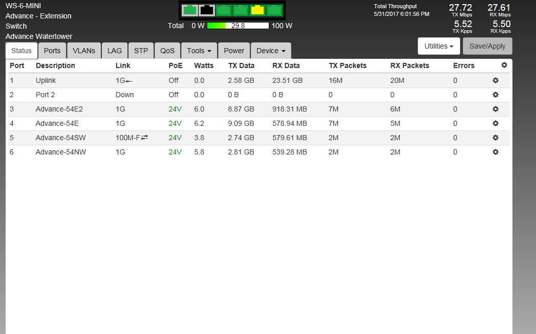

Well since changing port 6 to be 100F instead of 1G I now am looking at ~11 hours of up time with no lockups.

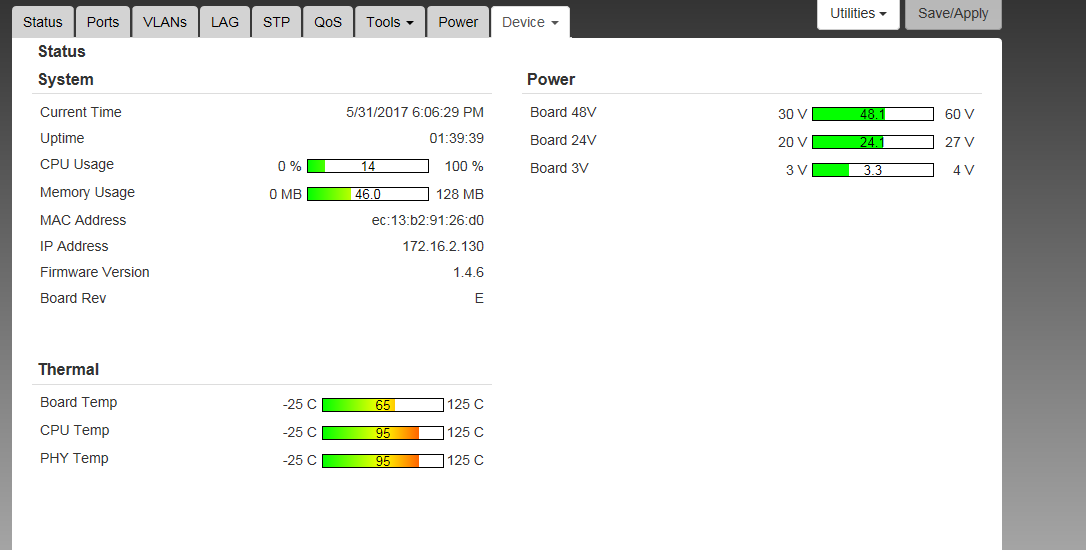

3.1v is marginal. On-board power reset circuit asserts RESET* to CPU once 3.3v falls to 3.0 - this is to ensure a tidy shutdown during normal depower, 3.1v is a bit close for my taste.
Short version, it probably is affected, but to a lesser degree than the one on the tower. In my testing here, it can take up to 24 hours for the oscillation to reach the critical voltage and start boot looping, but once it starts it will continue to cycle at a more rapid pace until it can no longer finish a boot sequence.
The fact that you're sustaining 6 gigabit links might tend to tell me that you'll be okay in your particular application, but no, your switch isn't right. Let me know what I can do to help, I'm definitely at your service via here, or email.
