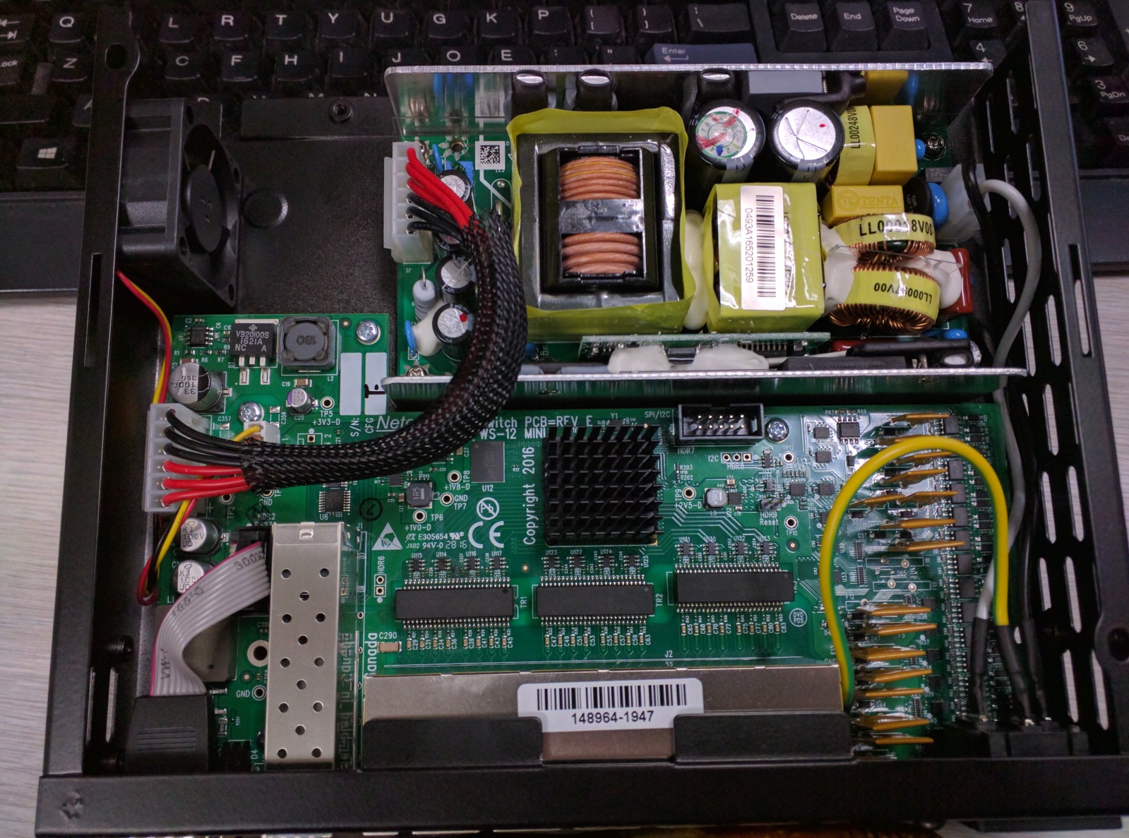

First, I want to point out the my airfiber and all 6 of my sector antennas where taken out by this.
Today I took apart the switch as sirhc advised, I didn't spend much time on testing the hardware as I don't have the time to spend on this.
I do see damage on the top of the board but I don't see any damage on the bottom of the board, please see attached
Re: WS-12-250-AC Overvoltage - Killed all radios attached to
I edited your post to display your picture the correct way.
Please read my post signature on the proper way to upload and display pictures in a post.
Did you remove the switch board to inspect the bottom, that is the only way to inspect the bottom.
Then when you get time follow my instructions on how to test it.
Then you should open an RMA to have the unit repaired as we will repair any unit for a modest fee even if it is out of warranty period and damaged which is not covered by normal warranty.
If it requires a NEW board the cost is $150 but if the board can be repaired it could be a lot less than that. Since the board boots there is a good change the board can be repaired.

If you lost your AF radios then you took a hit and the switch survived but the AF did not.
The switch can not change polarity on PINs or magically generate more voltage than the power supply can put out so it is impossible for the switch to fry a 48V device.
It can as I said if the MOSFET is damaged put out 48V on a port when it shouldn't or when it is told to put out 24V but there is no way to put out more voltage than the power supply sends the switch board or magically put different polarity on different PINs so there is no way for a switch to fry a 48V device like an AF.
You lost the tower in a "storm" but you are insistent that it is the switches fault and it simply is not possible for the switch to damage an AF radio which uses 48VH as the switch can not put more power out than the power supply generates and the AF is already expecting power on all 4 pairs so there is no way to do any harm to an AF radio.
Since the switch is powering up and if you verify the power supply is indeed supplying the board 50V+/- that tells you the surge did not come in through the power supply or it would be dead so the tower took either ESD, or there was significant ground current flow between the tower and the electrical service ground rods which would mean you do not have your tower ground rods properly bonded to your electrical service ground rods.
Do you have a heavy wire like #2 running between your tower ground rods and your electrical service ground rods bonding them together?
You might also want to add additional ground rods to your electrical service ground rods and make sure all connections are corrosion free.
Ground current is the #1 cause of WISP equipment damage.

1) You removed my 2nd picture showing the close up of the damage of the switch. Also, I did take out the board and look, and I said that the bottom of the board had no damage in my last post.
2) The tower and building is grounded. It's at a FM radio station that done a lot of work making sure everything is grounded correctly. The building has 8 foot grounding rods in each corner of the building and are strapped together using a 4" copper strip. This also ties into the electrical service grounding rod. The tower is also a part of this grounding loop and adds 2 more grounding rods. The grounding loop is also attached to the equipment racks to ensure everything is on the same grounding setup.

I did not remove your second picture I simply did not see it so I could not insert it properly.
Please edit that post with the missing picture and upload and attach the second picture and then insert that picture into the post below the first picture.
As I said though there is no way the switch can damage a 48V POE device except in this rare situation:
Say you have a Titanium Rocket in port 4 and the port is set to 48V but since that port is capable of 48VH and if the switch port 4 MOSFET circuit takes damage and applies 48VH instead of 48V to port 4 the Titanium Rocket can not deal with 48VH so it would be fried. But an AF does accept 48VH (power on all 4 pair) so it can take power on all 4 pairs as that is what it wants and the switch can not do a Jesus think and turn 48V into a voltage higher than the AF can use. Besides I think the AF radios can handle up near 60V anyway but this is a mute point because the switch can NOT put out that much voltage it is impossible.
There is nothing that can allow the switch to send more than 50V+/- to a 48V POE device so there is no way to over voltage damage it.
There is also no way for the switch to produce more than 24V+/- but if a port MOSFET circuit is fried it can output 48V on a 24V port which will fry a 24V POE device.
Your tower went down in a "storm"......the switch sort of survived.
Now you can determine if some of the ports or all of the ports are sending out 48V (50V+/-) instead of 24V or even when told not to send any POE which obviously 48V will fry a 24V device.
So I can see 24V devices that maybe survived what ever happened here then got fried by the switch which also took damage and is sending them 48V but there is no way the switch could damage a 48VH device, simply not possible.
I am very interested when you get time to test the switch out which ports are stuck at 48V POE.
I am also interested in you to confirm that 24V is 24V and 48V is 48V (50V) and that the switch is simply reporting voltage incorrectly in the UI due to damage most likely from the 3.3V sensor which is used as a reference voltage to calculate the 24V and 48V readings. So if the 3.3V is incorrectly reading high it will make the 24V and 48V readings high like you see them being reported but they are not actually high.
