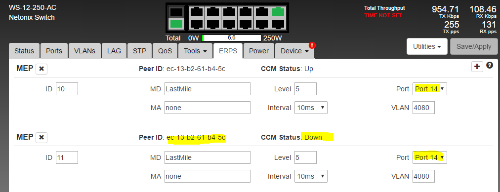

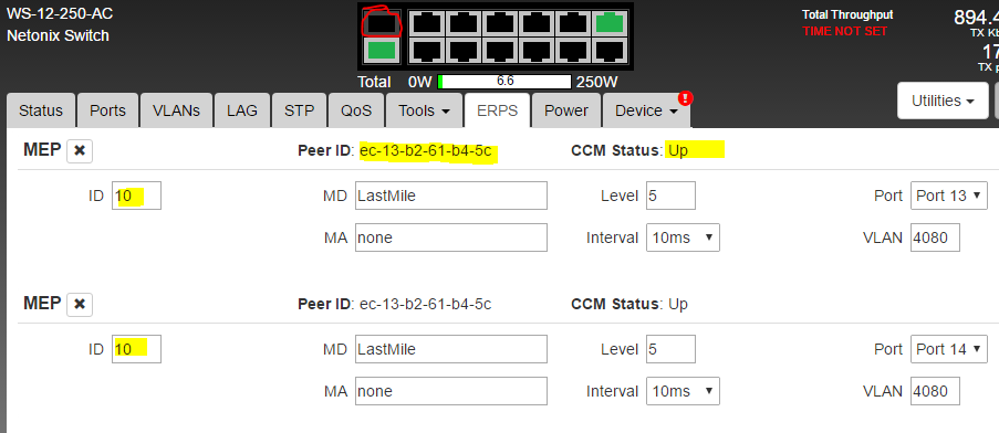

Same PEM ID is accecpted if using same PEM ID on 2 PEM config, the status of the PEM is broken on one of the PEM configuration since it will show the PEM status of the other PEM config.
Also, is the're any way to configure a PIM if we don't want the port to be a end point ?

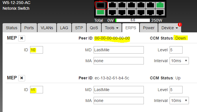

Will also accept 2 MEP config on the same port that also break a little the status by reporting a Peer ID while CCM status is down.

mike99 wrote:Also, is the're any way to configure a PIM if we don't want the port to be a end point ?
No, only MEPs are supported.

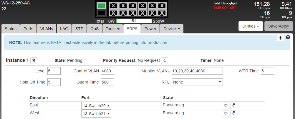

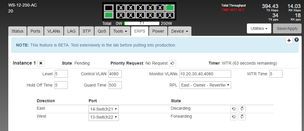

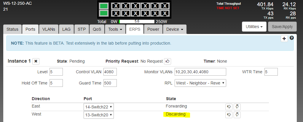

First, I'm not so familiar with ERPS but readed a lot about CMF an ERPS and also tryed several time.
My test are not conclusive at all. It's totally unreliable. If it work, I just have to unplug and plug back SFP and soon enough (2 or 3 trys), loop will happen and switchs reboot :-/ I started with a MEP instance but removed it to try if it would be more reliable. One good thing, even without MEP, it still converge really fast, ping won't even see a paquet lost.
My config is really simple:
VLAN 10, 20, 30, 40 and 4080 in monitor, management vlan 1 is exclude between 20 and 22 since it was worst when I tryed to include it. Often, switch will not even be reachable, even after a reboot.
Sometime, after change in VLAN or ERPS, the switch are not reachable at all, even after rebooting the switch. I'm not able to see any error, ERPS and STP (disable anyway) are in forwarding state but switch connected to it won't ping until I remove erps via the console port.
Exemple:
21# show vlans
ID Enable Description 1 2 3 4 5 6 7 8 9 10 11 12 13 14
1 true Management E E E E E E E E E E E E U U
10 true E E E E E E E E E E E E T T
20 true E E E E E E E E E E E E T T
30 true E E E E E E E E E E E E T T
40 true E E E E E E E E E E E E T T
4080 true E E E E E E E E E E E E T T
VLAN 1 IPv4 Address: 192.168.1.21/255.255.255.0
21# show erps
Instance 1
Level: 5
Control VLAN: 4080
Monitor VLANs: 10-4080
WTR Time: 1
Hold Off Time: 5
Guard Time: 500
RPL: West - Neighbor - Revertive
State: Protection
Priority Request: Signal Fail
Timer: None
East Peer (Port 14) State: Discarding
West Peer (Port 13) State: Forwarding

I'm connected to switch 20 and can still access switch 22, connected through switch 21 (SFP between 20 and 22 disconnect), while 21 show west port (RPL neighbor) show discarding mode status.
You can view previous schema to understand better.
After I plug SFP between 20 and 22, everything status are shown fine with RPL owner (sw20 port 14 - est) and RPL neighbor (sw21 port 13 - west) showing discarding status).
