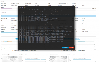

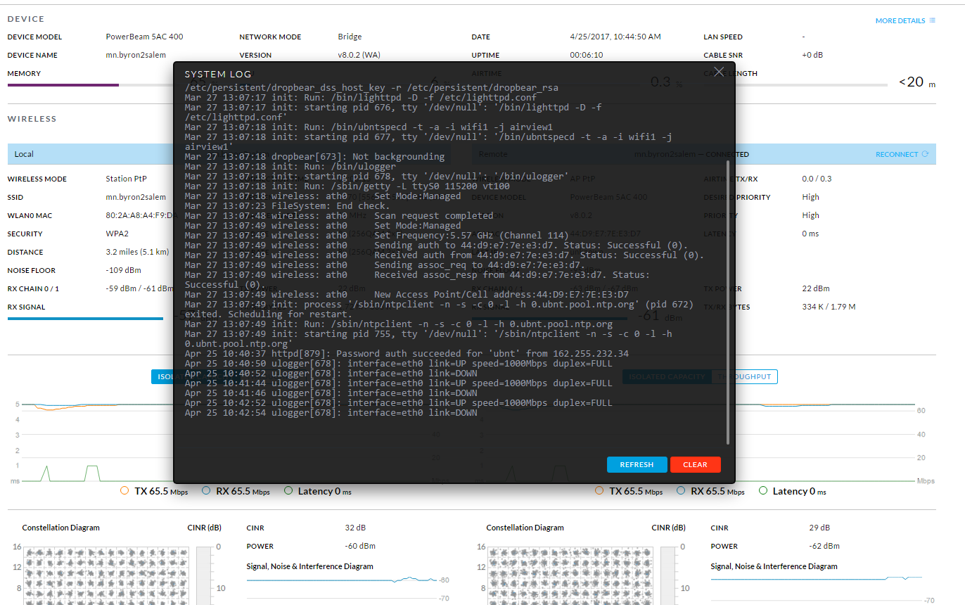

We replaced everything besides the switch to try to rule everything else out. New cables, new RJ45, new UBNT feedhorn, new POE injector, etc. The ethernet data link continued to drop and show unplugged on our radio that we could access over the wireless link. Rebooting the feedhorn would not restore the ethernet link.
Only power cycling the entire Netonix mini 6 would restore ethernet access for time ranging from an hour to 2-3 days before data dropped again. When I view the logs on the feedhorn as shown in my attachment, you can see the ethernet port cycles to 1000 Mbps then drops 2 seconds later. It will do this but never fully restore without a Netonix reboot.

I'm very confused. I'll attach a screenshot from the feedhorn that I could access wirelessly. During this time when ethernet was down, I cannot ping the switch or login at all so I can't provide logs since ethernet doesn't work on any port.

Here's the screenshots showing no LAN link and then the log showing the interface going up and down. The feedhorn is brand new as of yesterday and replaced a 3 week old feedhorn.
