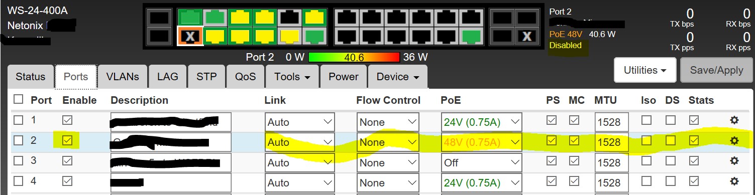

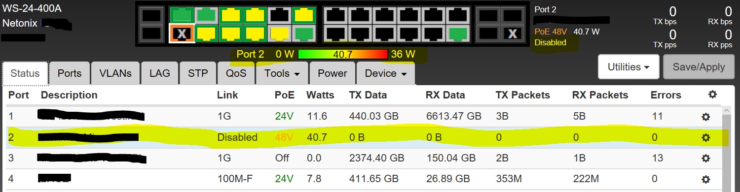

Below and attached is a visual of what I am experiencing, but I will also attempt to describe it. I recently replaced a WS-12-250B with a WS-24-400A. The first thing I noticed is that I was unable to power my radwin from it, (see images). Also, after the replacement, I started receiving slow speed complaints from customers. Last night, I moved back to the old switch and the issues cleared up.
[img]C:\Users\eric\Pictures\ws-24-400a_ports.jpg[/img][img]C:\Users\eric\Pictures\ws-24-400a_status.jpg[/img]

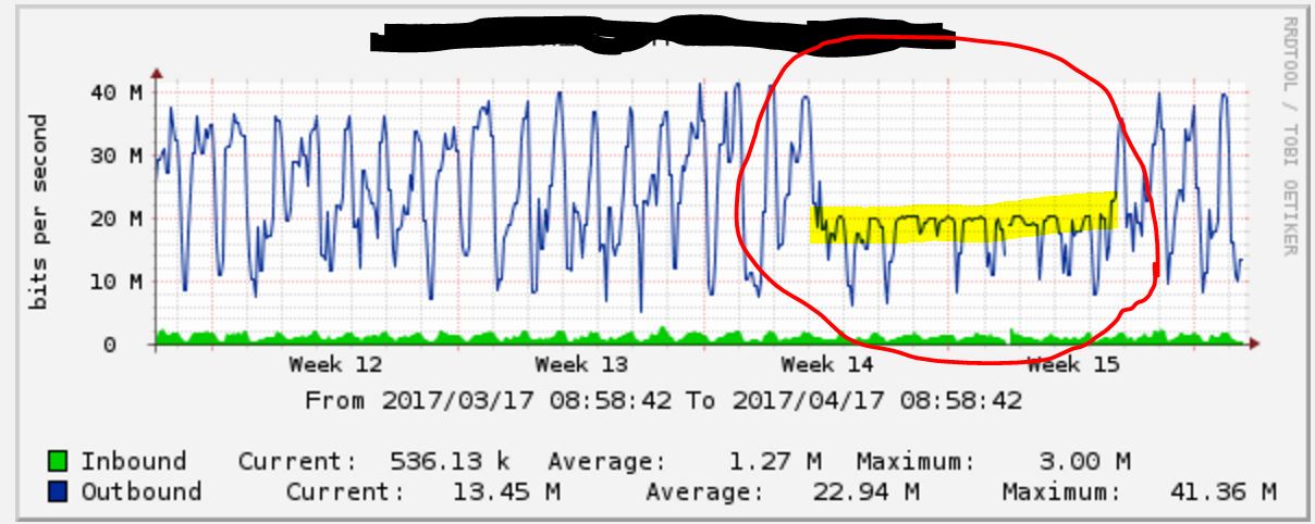

This image shows the time that the new switch was in place, (circled in red), and as you can see, the port maxed out at 20m during that time.
[img]C:\Users\eric\Pictures\netonix_graph.JPG[/img]

40w on a 48V port is 25% over design specification, I don't know if current sensing is functioning properly on that port. Does it sense current with power applied and no load?
What is on Port 2?
What is on Port 2?

Port 2 is the Radwin that we are trying to power. If I disconnect the Radwin from the port, the current drops to 0. Also, the problem follows to any port I try to use. I will update the firmware tonight and test again.
My other concern is that the graph in the top image shows that throughput was choked to 20M on the new switch on port 8. The highlighted period on the graph shows when the new WS-24 was in use. as soon as I removed it, throughput recovered. I don't know if this affected other ports, because the traffic on the other ports is below 20M. The only port I can say for sure is Port 1 as that is our backhaul, and that did not seem to be affected.
Thank you
Thank you
Re: Strange port behavior
What model RADWIN?
Do you have a link to a spec sheet?
We need to determine why your pulling 40W on a 48V option which is too much.
Read this post for POE options and what PINs are what: viewtopic.php?f=6&t=1178#p8809
If that radio uses 40 watts we need to determine if it is safe to use 48VH to power it.
This post explains the POE options and what PINs provide power with each mode (polarity):
Also after you upgrade I would review each TAB of both switches as there has to be something different between your configs as the switches are the same just one has more ports. Same switch core, same firmware, the same.
