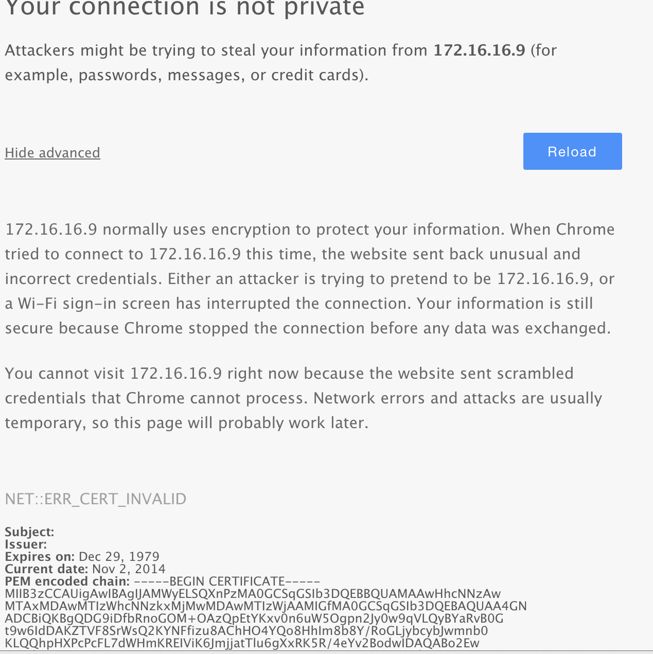

Here is the message I receive... can't seem to get past this warning and access the UI of the switch unlike other HTTPS sites with untrusted certificates (like ubiquiti equipment) where once you click Advanced there is a Proceed button, which lets you in.
Problem loading switch interface in Chrome on Mac

This is caused but the default Linux date being so OLD, 1969 to 1970.
You can fix it by setting the correct date on the switch via NTP service and then run this command at the Linux console
openssl req -new -x509 -keyout /etc/config/lighttpd.pem -out /etc/config/lighttpd.pem -days 3650 -nodes -subj "/"
Remember when you console into the switch you are first landed on our CLI not the Linux shell so you have to type "cmd" and press enter to drop to the linux shell.
After you are done type "exit" and press return to return to the CLI and then type "exit" and press enter again to exit the console.
This will be fixed in the next release of firmware later today.
Thanks for pointing it out.

Unfortunately the procedure still hasn't solved the issue on Chrome on the Mac. While the date of the certificate is correct now, with it expiring in 2024, I still receive a NET::ERR_CERT_INVALID error stating:
I received this message after updating to the newest firmware and running the command posted in the thread, which seemed to successfully update the certificate since it now displays a new date.
Any ideas? Would really like to be able to use the Mac and Chrome to monitor the switches.
Thanks.
Thanks.

nelson05 wrote:Unfortunately the procedure still hasn't solved the issue on Chrome on the Mac. While the date of the certificate is correct now, with it expiring in 2024, I still receive a NET::ERR_CERT_INVALID error stating:
Thanks.
Chrome on Mac OS is really fussy. Anyways, I was able to get it working by using this command (just a small change from the above one):
openssl req -new -x509 -keyout /etc/config/lighttpd.pem -out /etc/config/lighttpd.pem -days 3650 -nodes -subj "/C=US"
Of course make sure the time is correct on the switch before doing that.
After that you need to restart the web server (so it loads the new certificate) with this command:
/etc/init.d/lighttpd restart
Then reload the webpage in Chrome and it should allow you to continue.

Re: Problem loading switch interface in Chrome on Mac
That was just what I needed. Working fine now on Chrome/ubuntu. Thanks Eric, you da man!
