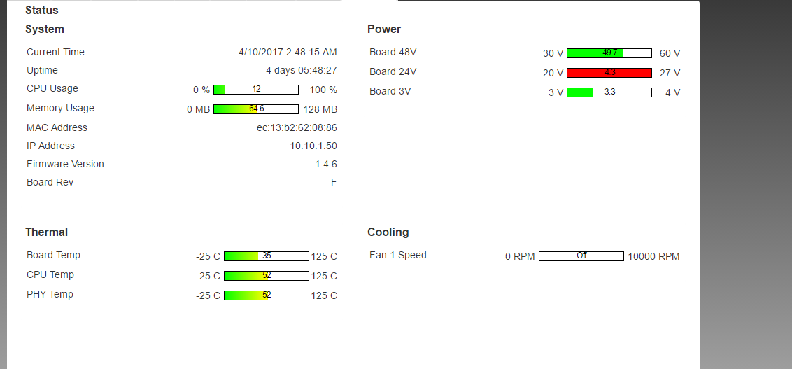

Brand new Netonix WS-12-250-AC. After a few days working it started acting up all of a sudden.
In log the following show up:
Apr 10 02:40:29 switch[2782]: Detected cold boot
Apr 10 02:40:34 switch[2746]: 24V is out of range (4.3V)
Apr 10 02:40:39 switch[2746]: Warning: expected 1 fans but found 0
The switch powers only an AF24 nothing else.
Attached screenshot.
Please assist.

Either the unit failed or was damaged.
You will have to RMA it to determine which it is.

The fan was really noisy since first boot and then it failed along with the 24v supply as it would seem.

Yep, like he said -- will need to RMA to restore function. The fan is powered by the 24v supply, and I have seen a few odd cases where the 24v circuit will cease to function, or be dragged down externally by failing hardware.
If all you'll ever power is an AF24, (meaning no 24v devices), and your temperatures seem stable (bearing in mind that the system is rated to operate at 55C ambient, and tested over 90), and everything is stable, it's up to you if you want to return your switch, since everything still works in your application (aside from some power and fan related log entries).
