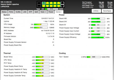

These is my Netonix Status Page
Re: PROBLEM (Noise) WS-12-250-DC - 9 Rocket M5
Everything looks good there?
As I said maybe you have a ground current issue?
