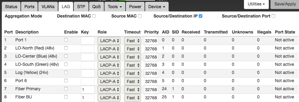

After having a switch go bonkers on me today (I'm sure self inflicted), I need to get a better understanding of why and I say this humbly since it is my own doing.
I have a WS-8-150 DC at the top of our tower powering 3 ePMP APs. It is connected to the bottom of the tower (a WS-12-250 AC) via 2 fiber pairs (for redundancy).
On the top of the tower, they are into SFPs in ports 7 & 8. At the bottom, they are in SPFs in ports 13 & 14.
I thought I had STP set up where if one fiber line failed for whatever reason, the other would take over. Today, I got a bunch of STP errors in my log and suddenly no traffic was being routed up the tower. Again, this is my doing.

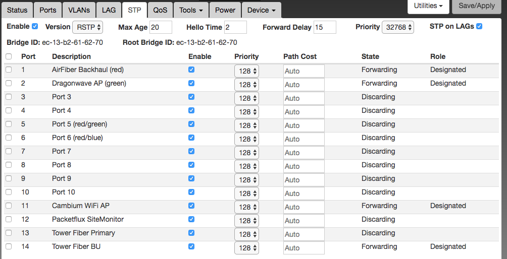

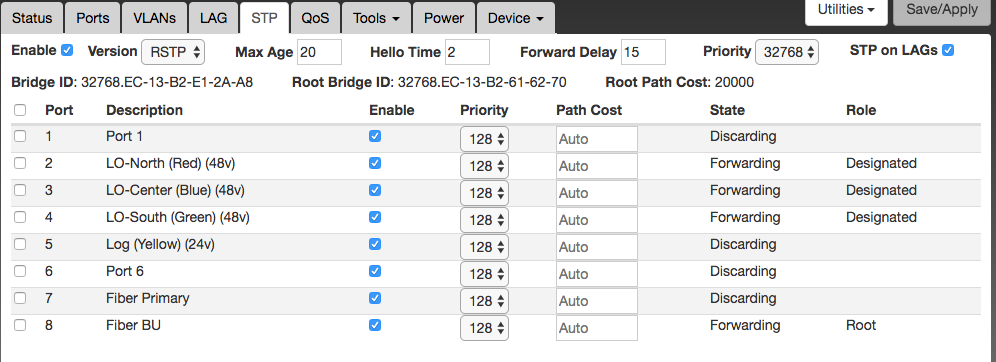

I have attached screen shots of LAG and STP of both switches. It's not right but I don't know why. And, should I use LAG over STP for simple double pair redundancy up a tower??
Top of the tower:
Bottom of the tower:
I'm much better at reverse engineering a correct setup...
I wish I was smarter (LAG vs STP)

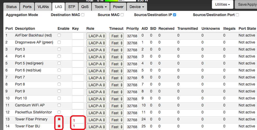

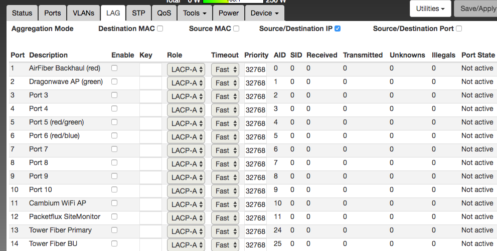

So first off I am not sure why you did not play with LACP in the LAB before implementing it in service???
Anyway your screenshots are NOT correct
You have the LACP Key set at the TOP correctly but the LACP ports are NOT ENABLED?????
You do NOT have the LACP Key set at the BOTTOM at all and the LACP ports are NOT ENABLED?????
Might I suggest you read up on LACP and then play with 2 units in a LAB environment before implementing LIVE?

As far as gaining control of switch should be simple, use ONE of the fibers by unplugging the other.
You may need to power cycle them?
Your main problem occurred because your did not have LACP setup at all.
You only specified the Key on one end and you failed to enable LACP ports on both switches.
At this point you have a LOOP which RSTP was trying to deal with the loop but if all your switches have RSTP enabled then things would shift around when you unplug things and depending on your RSTP settings a new Root may be established.

We did have LACP setup and working - after those screen shots were sent. Key was 10 on both ends using an active LACP. Both ports on top and bottom were enabled. We tested it by dropping a fiber and the LACP functioned as it should. That was all post screen shot where we were not using LACP.
About 12 hours after putting the LACP into action, we lost the switch when we powered down a POE port at the top of the tower. That same POE port had been designated ROOT even though it was attached to an AP serving customers. None of the customers below it can have DHCP traffic coming upstream - or radios do not allow that.
We have power cycled the radio a couple times. I have turned off both of the fiber ports separately. We tried turning off the LACP at the bottom and shutting off one of the fiber ports. Nothing gets any packets to return from the top of the tower.
I have TFTP auto backup enabled so I have a copy of the latest working config just before and just after we turned off the POE power at the top switch.
