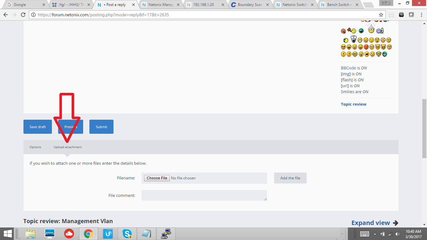

below the 3 blue buttons that say save draft, preview, and submit, there's a grey bar that says options, with 'upload attachment' next to it, see picture
once you're done, you can scroll down and hit the 'place inline' button if you want the attachment displayed near a particular body of text.

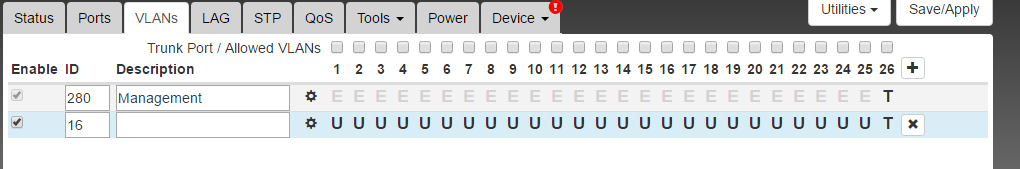

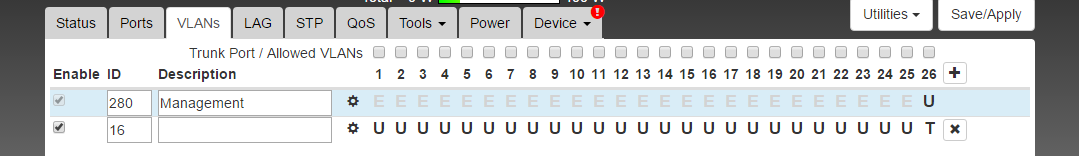

so which one of those works?

Both setups work for the 16 vlan traffic. But I loose management access to the netonix..
Is the correct setup normally to T the trunk port on the MGNT Vlan? or to untag it?

Re: Management Vlan
Thu Mar 30, 2017 10:54 am
So with this VLAN configuration one could ONLY talk to the switch through port 26 with Untagged packets.
Port 26 would only accept VLAN Tagged packets with an ID of 16 and Untagged Packets, all other packets would be refused or dropped.
Untagged packets coming in Port 26 would only go to the switch UI/CLI.
All Packets Tagged with VLAN ID 16 entering Port 26 would exit ports 1-25 as Untagged packets.
With this VLAN configuration one could ONLY talk to the switch through port 26 with Tagged packets with a VLAN ID of 280
Port 26 would only accept VLAN packets with IDs of 16 and 280, all other packets would be refused or dropped.
Ports 1-25 will only accept Untagged packets, all others would be refused or dropped.
Packet coming in port 26 and out Ports 1-25 would have the VLAN ID Tag 16 stripped off and exit as Untagged packets.
Untagged packets coming in Ports 1-25 and exiting Port 26 would be encapsulated with VLAN ID Tag 16.
