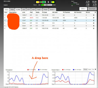

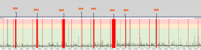

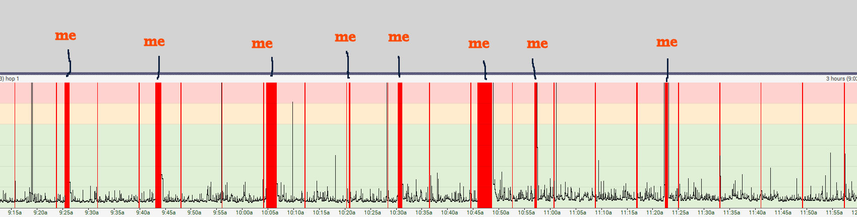

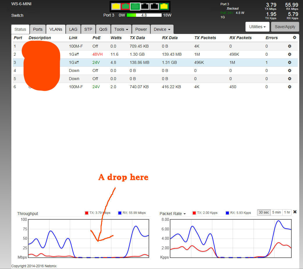

You can see the 8 minute drop is constant even if I reboot or do anything in between. The big reds that I marked are me upgrading firmware and rebooting and trying things.

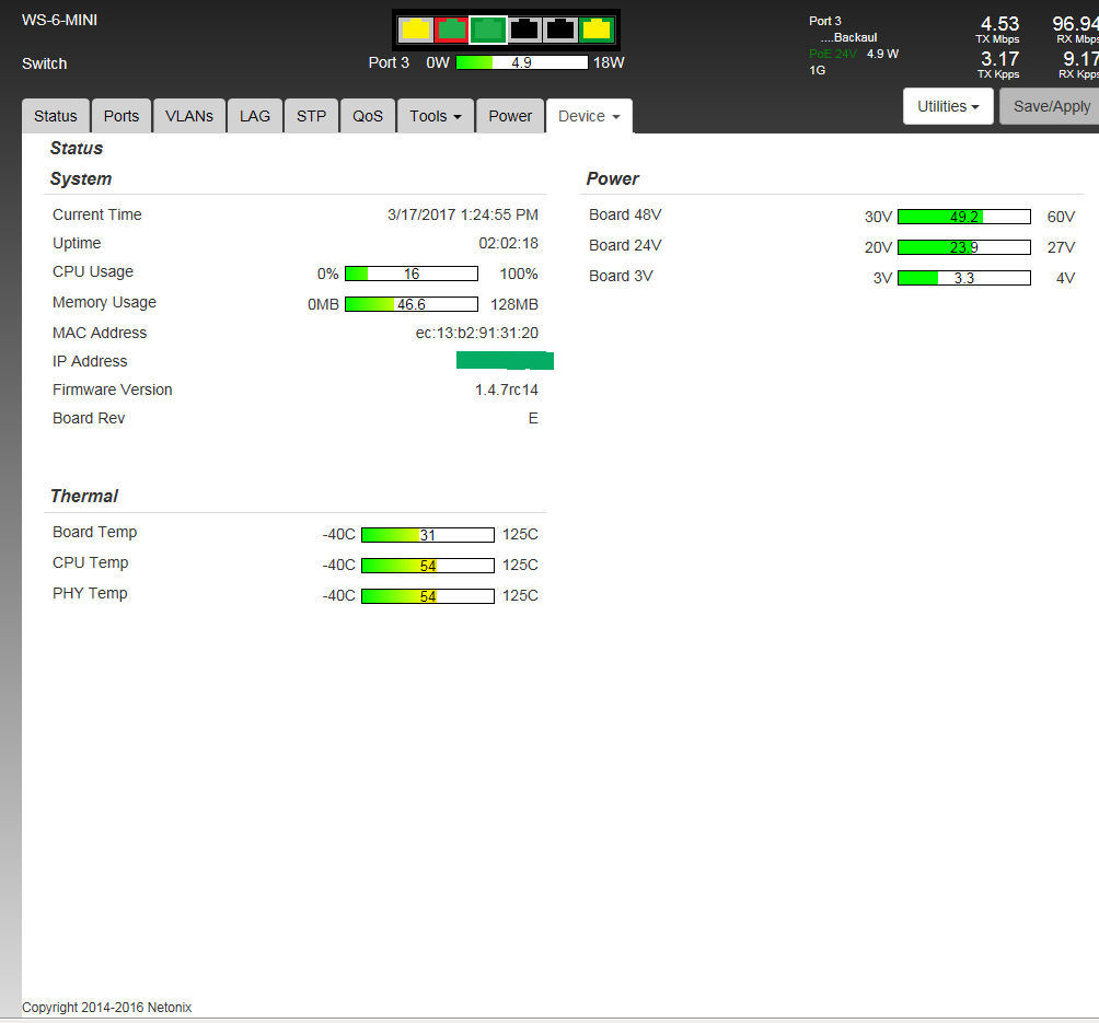

What is powering the WS-6-MINI?
Post up Switch Tabs:

Device/Status

Device/Status

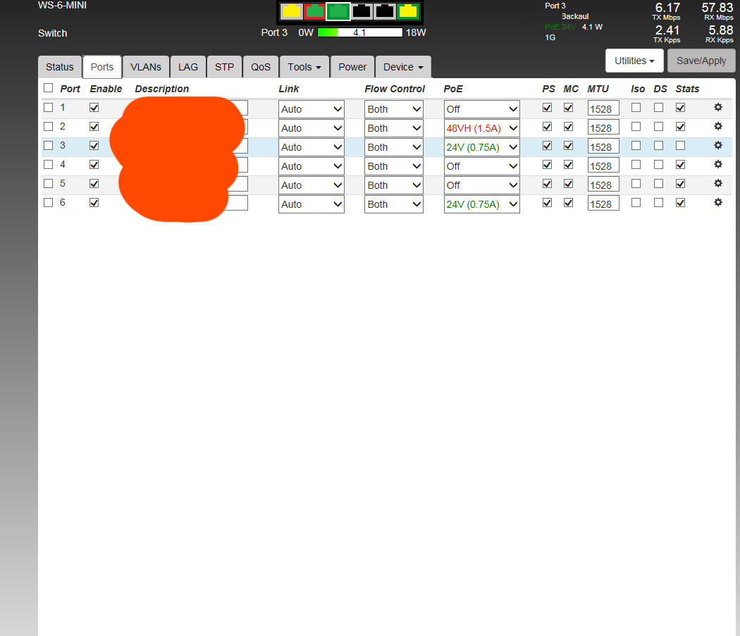

Tell me you have the port in the switch set to AUTO and the radio port set to AUTO correct?
NEVER HARD CODE SPEED DUPLEX
Re: port drop every 8 minutes
yes both auto showing 1 gig I have those screenshots. Watchdog and Port bounce have nothing they are not on.
