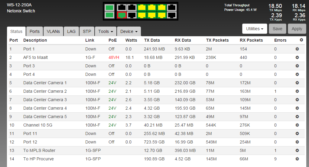

Here are a couple of screen shots showing the simple config.
I forgot to verify the cable when I was there today but I'm 99% sure they got plugged in to the right locations.

It appears that untagged frames are passing just fine. It's only when you tag that things don't work correctly.

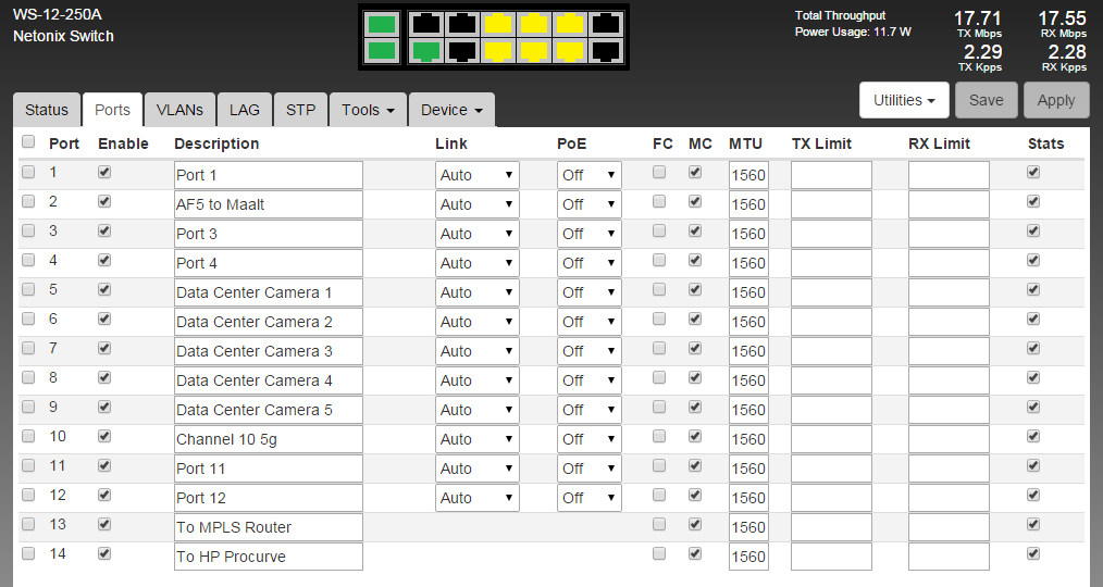

Defaulted the switch and no change on passing tagged frames....
however...
I also found another oddity (bug?) from a default config, I had not turned on any power to any of the ports yet my cameras are up and passing traffic???? I will start a new post on this as well.
however...

Re: Issue with WS-12-250X using port 13&14 in VLANS
This is your second post on the same issue.
No that should not occur, this is an over sight in my count.
But I know why, I will have to have Eric fix that tomorrow.
If you remember we changed the unit so that you can reboot it and it leaves the POE ports on during the reboot or after a firmware upgrade ti limit radio down time.
I did not think about people having POE turned on or configured on then defaulting it in the UI.
If you power cycled it would turn them off to match the defaulted config.
I will have Eric make sure he turns all the POE off if you do a software UI default.
Good catch
Good catch
