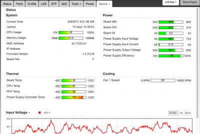

Similar issue two nights ago with a WS-8-150-DC at the top of a tower. At 4am local time, I got woken up to our SNMP alarms telling me the two APs on that switch were off. Logging into the switch showed they were powered down due to over temp of the power supply controller. It lasted in this over heated state for about 15 minutes and then cooled down and re-activated POE. The fan never reported being on in the GUI during any of this. This switch got back from RMA a few weeks ago (bad solder connection found) and has worked great until this incident.
Switch is connected to ground at the top of the tower - dedicated #6 for the switch and radios. It is tied to tower and electrical ground at the bottom. Switch was running 1.4.7rc18 at the time of the failure. It has been upgraded to 1.4.7 release today. The issue has not come back but I am always nervous when things happen I can't explain.

The power supply controller temp was not being taken into account in the fan control algorithm. This will be addressed in the next release.
Re: Temp in power supply controller
Thu May 11, 2017 2:51 pm
v1.4.8rc2 has been released to address this issue.
