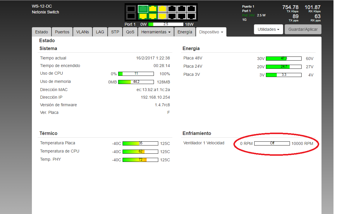

My problem is that the ventilated does not work.
I've tried restarting and it's not going either.
Fan does not work (ws-12-dc)

Fan does not turn on until Board temp is over 40C or CPU or PHY is over 100C

Re: Fan does not work (ws-12-dc)
sorry for the inconvenience.
But I saw that the CPU temperature is above 60
I'm sorry, I was wrong.
Was referring to the temperature of the board (40º)
nuyra2 wrote:I'm sorry, I was wrong.
If board temp is over 40C and fan is not ON then you have an issue.
Have you seen Board temp over 40C and fan was OFF?
